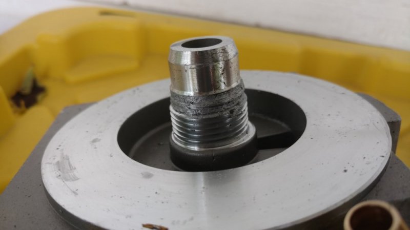

Nessmuk Well-Known Member Messages 432 Reaction score 276 Location East Amazonian polar region Jun 16, 2017 #1 Don't buy the solid aluminum ones unless your never going to run a filter with aluminum threads in it. I put a cat filter on one and it galled. A filter wrench won't turn it. I'm going to have to cut it off

THEFERMANATOR FRANKENBURBAN Staff member Moderator Messages 10,575 Reaction score 5,791 Location ZEPHYRHILLS FL Jun 16, 2017 Staff #4 I know I got one from NAPA(stamped made in USA), but I'm pretty sure it has a steel stub where the filter threads on.
Nessmuk Well-Known Member Messages 432 Reaction score 276 Location East Amazonian polar region Jun 16, 2017 #5 Napa Wix is usually ok. Until they change to something cheaper.
