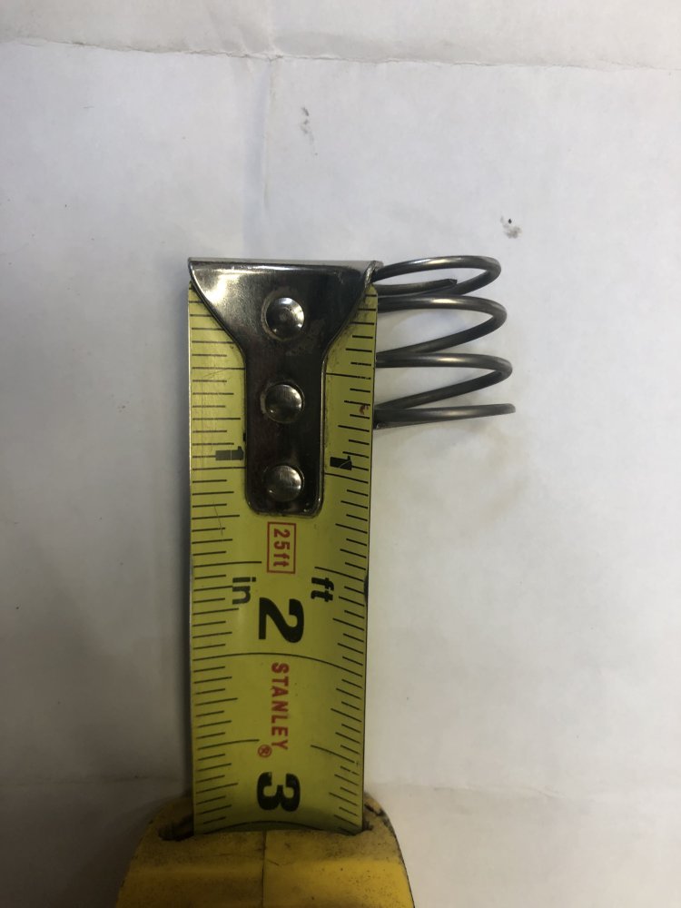

About ready to gain a mysterious prestone leak out the back of the enjun.
When I pulled the intake manifold this time there was a very small amount of prestone on one side at the back of the valley. Decided to replace the T-Stat cross over and rear passage cover gaskets.
T-Stat cross over off, head surfaces cleaned, something in the valley ahead of the injection pump, a spring, WTF ? ? ?
Magnet and fish it out. Give it a bit of a warsh.
I dont recognize it or remember ever seeing such a critter from this enjun.
Looked up the injection pump R&R and it done show a thing like that spring on that process. No warnings about being sure it is in there before installing the pump. If it come from that its been in the valley for a very long time.
Does anyone recognize a spring of these dimensions ? ?

Valve spring? Thermostat Spring?
Piston return spring.
Yeah, you might find the rest of your t stat parts banging around…
I checked down through all of the intake ports and none of the piston return springs was missing. The piston return springs are a little longer and smaller in diameter and not nearly as stout looking as this one.
I now am thinking that this spring must have come from a sprung thermostat sometime in the trucks previous life.
Most likely not an OE thermostat replacement but some other brand that had failed.
The OE thermostats that are in the housing is a couple of mighty stout units and I dont see how they could fail to the point of releasing their springs.
I guess this thread can be stamped as mystery solved and now lets hear some banter.
Oh yeah, I’m going to see if I can get the little bead blast cabinet to work good enough to blast the T-Stat housing and clean it up.
