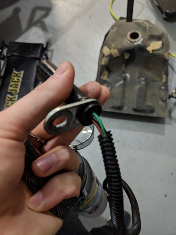

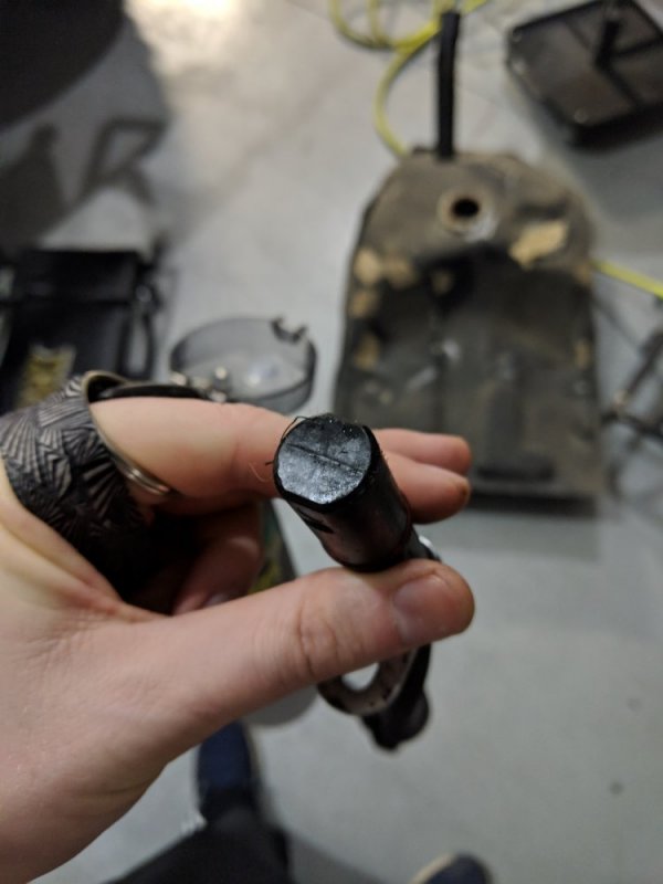

Update: swapped out the ckp sensor for an AC Delco unit, they do look very different. The am general one had no visible metal pickups at the end but the AC Delco one does. Sadly it didn't change a damn thing, the truck runs so terrible now like it is hitting on maybe 5 cylinders if I'm lucky. I think the IP just totally took an internal shit and the first warning sign was the stepper motor adjustments not doing shit.

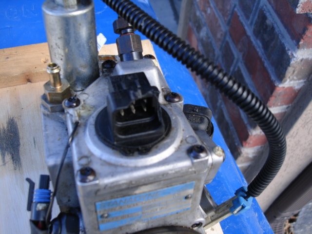

Which connector is the OPS? Top middle on the IP right 6 pin?
And no I dont have a diesel compression tester. But I can get one.
This is a brand new stanadyne pump benchtested prior to being sent to me from Leroy I seriously doubt the OPS is bad.

The OPS test is for wires and ECM at this point.
A compression tester would answer some questions and eliminate low compression as the cause or ...
I believe it's the top middle connection for OPS.
