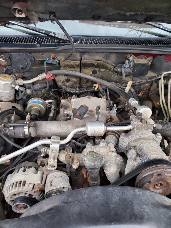

I have recently gotten a 96 6.5 turbo diesel looks like it came from up north it my first personaly owned diesel dually I'm looking to up grade a few things such as turbo injectors and intake system my truck has the f in the vin non egr still has the vacuum pump on it with a gm 5 turbo looks like it has a mass flow sensor on the intake along with another sensor that I'm not sure about

Nothing against you or your skills, but there is a ton of people here with tons of miles wrenching on these. No maf I can see.

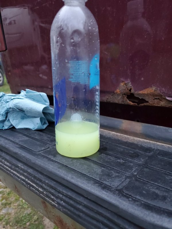

Ok so I just had to clean my tank out cuase this was in it and now my vacuum sensor went tits up I put a spring on waste gate temporarily when I hit a hill truck wont get over 35-40 but once I'm on flat land it'll get to 60 as I stated before this is my first personaly owned diesel so I'm a cherry to the 6.5L turbos my other truck is a 454tbi 1ton dually 20200315_194101.jpg
Darn. Better to know what’s happening though. If your not sure next step to take, it lease ask.
Looks like water from my phone. Drop the tank. Flush the lines. Use bug killer. run 10% heavier than normal stanandyne or whatever brand you use than normal for the next tank full on fuel treatment.
once together and running for a few minutes pay attention for individual cylinder or multiple cylinder misfires which could be injector damage. If you have say cylinder 1 misfire, swap #1& #3 injectors and see if misfire follows injector.
