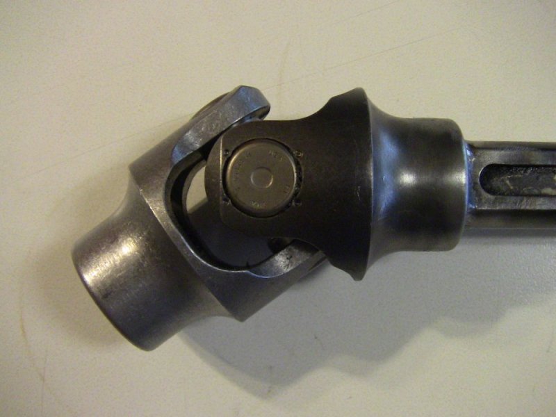

Now we have to remove the upper joint/rubber coupler. I used a die grinder, and cut it in half on both sides, and split it open to remove it.

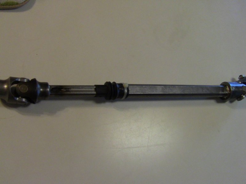

Now you have to mock things up. You will need to use the outer slip portion from the cherokee shaft as the GM one isn't long enough to allow for enough engagement of the slip portion and to slide in the joint end. I ended up cutting 4.5" off of the cherokee slip shaft to get it to the correct length, but double check yours BEFORE cutting.

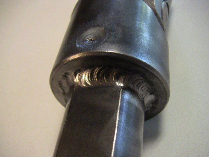

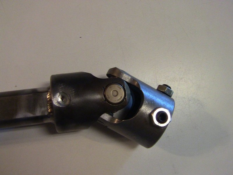

Now if your trying to do this with as little work as possible, you can slide the newly cut shaft in about 3 inches with the universal joint into the outer portion of the JEEP shaft opposite end of the rubber coupler, and either have it welded like I did, or drill it and through bolt it(I reccomend welding it to keep it as small as possible, last thing you want is a bolt sticking out and catching something as you turn the wheel). I wanted a sleek OEM look, so I burned then ground off the rubber portion, then used a cut off wheel to split the metal collar that teh rubber was atatched to, to get down to just the shaft.

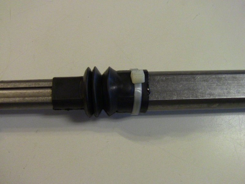

Now at this point you can grease the upper portion of the old shaft, put the spring plate back in the notch, slide it into the shaft, and put it back in the truck. I went ahead and made mine look factory so I could re-use the covers. I took the portion you see above of the lower shaft, cut the rag joint end off, there is a dimple in the bottom you have to drill out.
I slid it down over the welded shaft from above, and welded it in place using the hole from the locking detent earlier.
Greased the GM upper shaft, installed the spring clip, and put it all back together with the accordian cover and lower shroud leaving me with this.
Then re-install it in the truck, and realize the folly I made. The universal joint is MUCH longer than the rag joint was, so the plastic shroud for the joint will no longer slide down over and lock to the power steering line, so most of that extra work I did was for not. On the plus side though, there is ZERO steering slack, and the 95+ trucks will have tighter steering than this mod done to the earlier trucks. For those looking for tighter steering on earlier trucks, you can buy a BORGESON universal joint to install to take all the steering play out.
