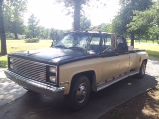

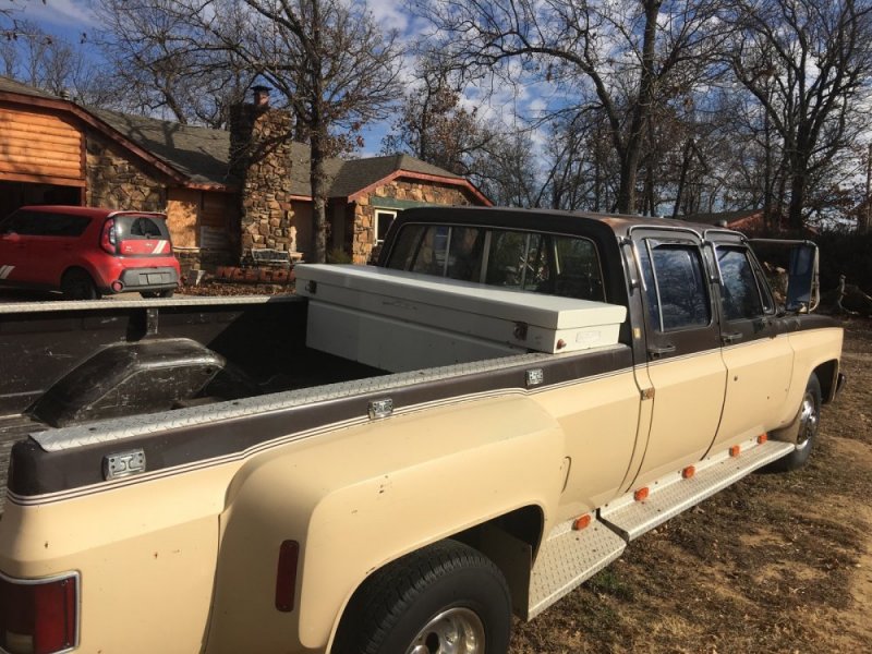

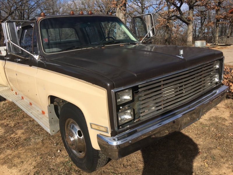

IMG_0295.JPG So I found a pretty clean 85 C30 3+3 dually with 6.2 and th400.
The flywheel has missing teeth and can't be started but the engine has decent compression.
Do you have to pull the the trans out to replace the flywheel? If so this sounds like the perfect time to slide my 4L80 in.

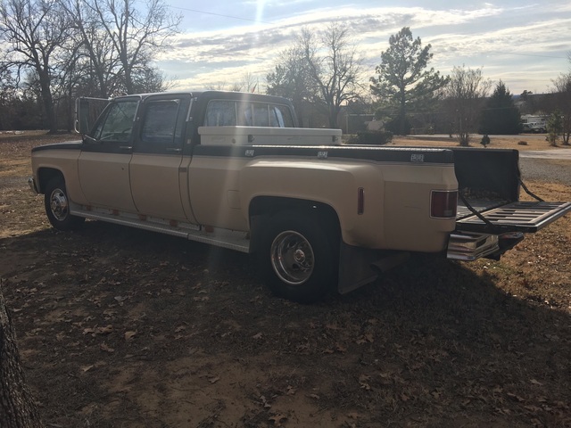

Yes I will have a build thread on this truck if the deal goes through. I really want the truck, I have always wanted an 80's crew cab dually and eventually I want it turbo'd with a 6 speed allison but until the a 4l80 with triple disk 2000 rpm converter will have to work while I turbo. Then I will work on interior followed by the allison as long as the exterior holds up.
