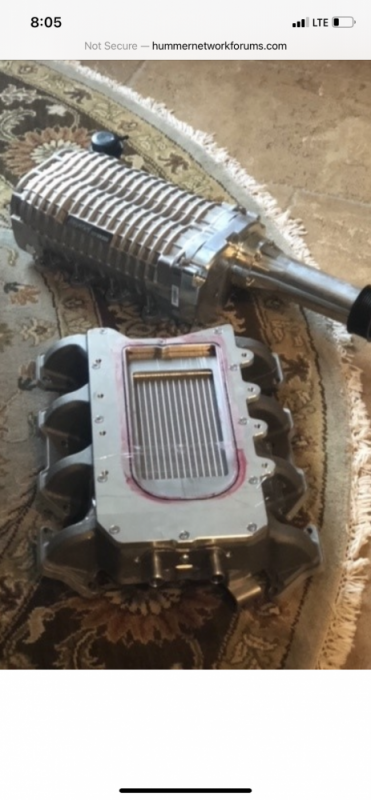

One of the guys on the Hummer forum (Tom65), a cool guy, bought this set up for his Hummer.
It’s designed to go onto n/a hummer heads which is same as normal heads in pickups.
I emailed them about pricing just the lower intake with the built in water to air inner cooler, waiting for the return info.
It was on a thread talking about inner cooling so he showed it, and included some info of his place for some parts:
http://www.siliconeintakes.com/ and mentioned that the bosch pumps are around $70 a d for a small fitting area he found a Derale cooler that fit in our compact radiator area well.
I didn’t realize until after sending the email, it gobbles up part of the the room for center mount turbo. So I cant use the intake, but maybe one of you all with the side mount can. Would be easy to make a plate on top for hose attachment, or two hose attachmentfor twin turbos...
I wonder how the CAC within the intake manifold would affect the engine cooling, and the combustion process with the intake air temp being much warmer.
I wonder if the intake air temp sensor would need to be moved to under the CAC to catch the increase in temp. For OBD2 systems.

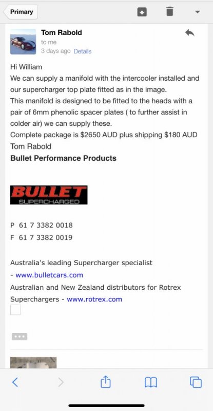

I got a reply back from the supercharger company- but am fighting my email right now. I had 3 emails that popped in in the last couple days that are not showing up on my phone app email. I will post it here soon as it gets fixed but it was over two grand for intake and innercooler. That much I remember.
Yeah, it like it is an unfair price. But enough cash and the no centermount area for me that I am out. Center-mount completely over the trans is a bit too much. A person could use the pipe style heat exchanger and that manifold one to pull out more heat.
Again, pickups have so much more room to work with.
Ok, email is goofing up, but I got this screenshot of his response.
Note the spacers he mentions they use to slow heat transfer into the manifold...
$2830 Australian is like 2181 US dollars.
the pic he enclosed in the email is just like above pic on Tom’s rug, without the supercharger.

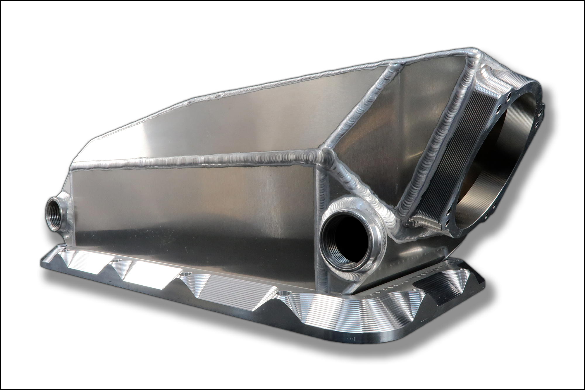

Its just painful to have an intake manifold and cooler cost twice that of what v8 gassers cost. I know- r&d cost and small amount will ever get sold.
Well a Holley High Ram is around 900$ without a cooler inside, the cooler inside is 1800$ more so I don't consider this that bad, I have about 1K in 1/2 a hand built intake and could not fab one as nice as this one seems to be for anywhere close to their price....
