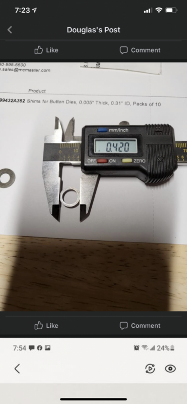

Go learn what ya can from this guy. He has a lot of years doing them and sells kits (read in his description under video) and can save you some time. He doesn’t do everything 100% right, but hits 85-90%
I just grabbed whatever video popped up from remembering his channel name.

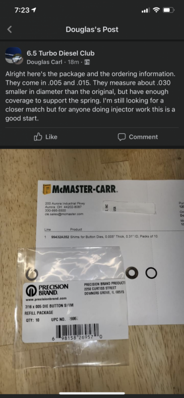

Look up peach parts also iirc

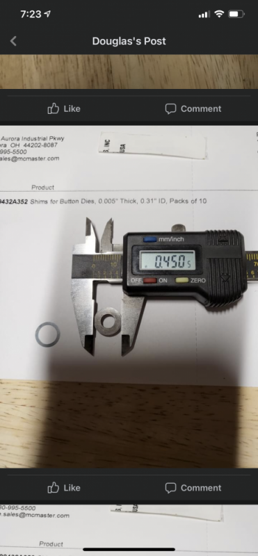

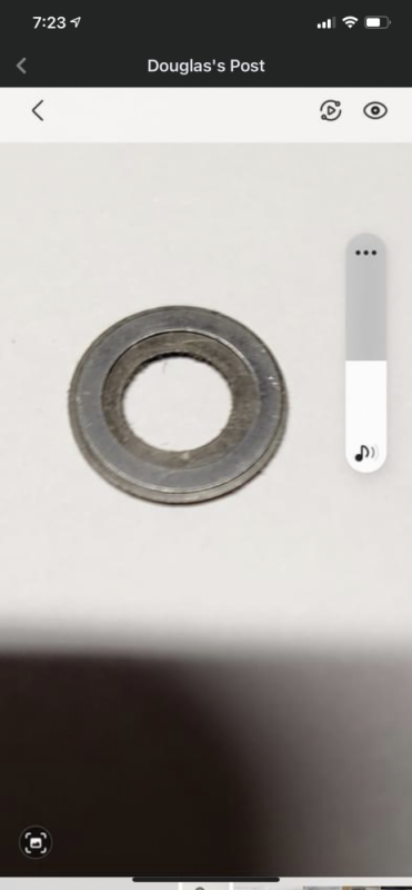

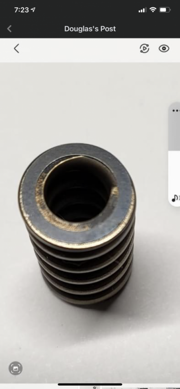

Oh yeah, the shim surface smaller than the spring — nopers. Spring is harder than the shim. That spring will wear into the shim. If a person had no other option, ok. Better than throwing away parts, But I would continue the quest.

yeah I was kinda thinking the same thing. What’s the cons of re-using the old shims? I assume the shim is to apply more or less tension on the spring which in turn adjusts the pop pressure. Low pop would need a thicker shim where a high pop needs a thinner shim. Is that correct?

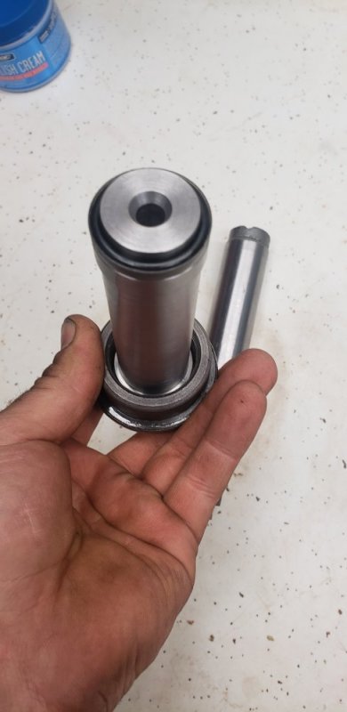

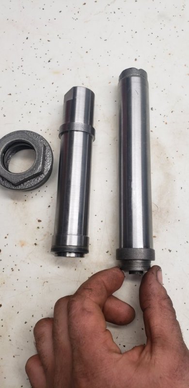

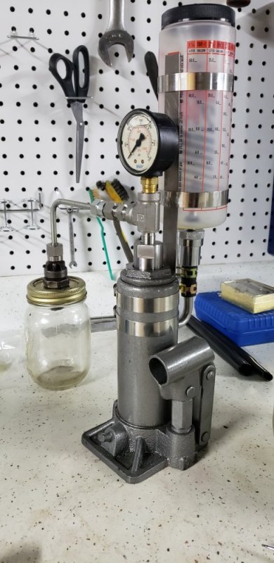

I built my own pop tester from a HF bottle jack. But I went about it a different way. My father machined up a new shaft that made the whole project alot easier. It uses the original seals on the lower and upper ends. He machine in a retaining flange to prevent the shaft from moving upwards. And a through hole tapped to 1/4 NPT. Even added a spot to hold the shaft with a wrench.
All the fittings are 1/4 NPT stainless, and I found a m12×1.5 - 1/4 NPT Male to Female adapter. WIKA pressure gauge, small filter coming out the bottom of the reservoir I made using a 2 stroke mixing bottle. Then had a custom m12×1.5 -m14x1.5 line made. Held it all together with some hose clamps and a piece of 1/16" stainless. Im happy with how it turned out.
As far as a source for shims, heat shield washers, and compression washers your best bet is ordering from Europe. Some of the bigger diesel supply stores offer shim kits and 10 packs of the other 2 washers. You need the correct 11.5mm od shims. Luckily VW and Mercedes IDIs use the same style injectors so they are easy to find. I've had no luck finding a good shim kit here in the states. I've reached out to a few pump builders and they all told me to order from Europe.

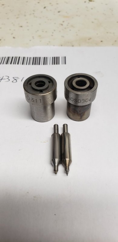

Ive taken apart stock and marine nozzles and did some measuring. They are basically identical except for a few differences.
*Marine nozzles have .003" more needle lift. And the pintle is .030" shorter.
So all they did for marine injectors is increase lift a small amount, and machine off the second stage of the throttling pintle.
Other than that they identical and throttle fuel on initial opening identically.
304 vs 311
Ive measured all the 6.2 and 6.5 nozzles as well as some VW and Mercedes. And I believe I found a better nozzle than the marine that im going to use for my build.
304 vs 311
