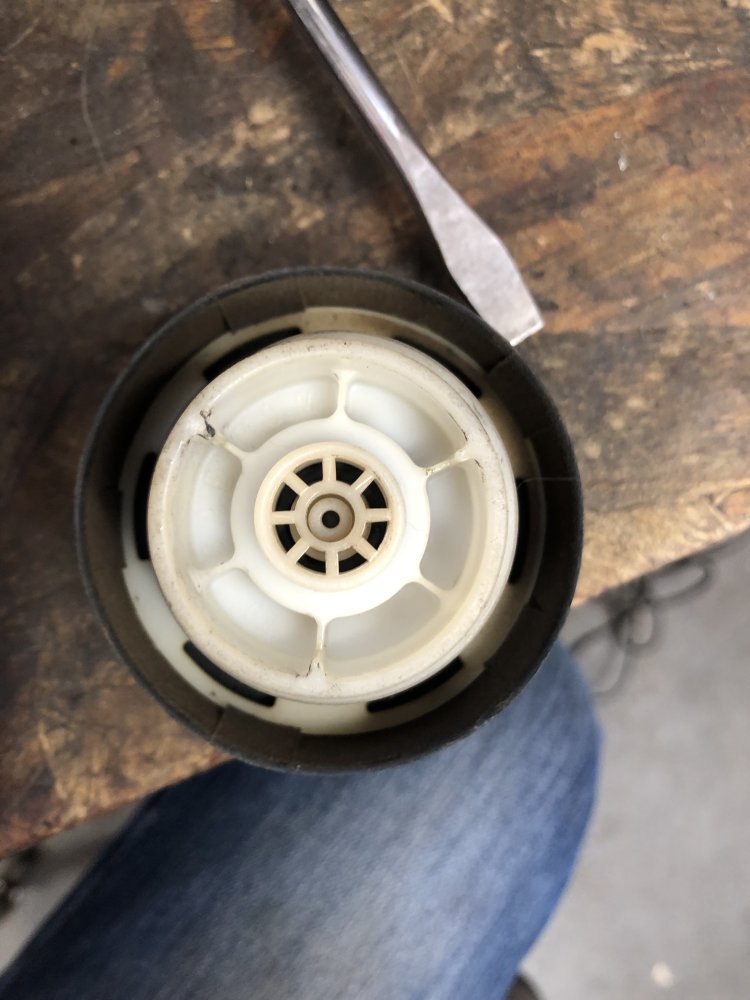

Pulled the fuel cap.
Took a peek at it. Appeared to be a check valve in the middle. Give it a blow, locked up. Drew a breath through it, it is vented to let air in and none out.
Guess thats a win/win situation. 🤷‍♂️
If it builds pressure then it just makes the job of the lift pump easier.
It will not let out the evaporative fumes of the fuel. Then as the tank and fuel cools it would draw vacuum- the one way just allows air in. Also allowing it in as the fuel is consumed and you need air to come in so it doesn’t restrict the lift pump operation.
Absolutely nothing wrong with a little pressure in the fuel tank. Definitely something wrong with vacuum in the fuel tank.
