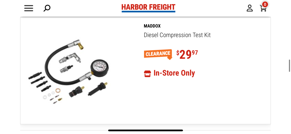

For you or anyone else needing a diesel compression tester:
Working with one a lot is worth the cost of a high quality unit. Doing it once every few years imo get harbor freight.
Here’s the bonus if you been wanting one but haven’t yet.
Right now the basic kit which does have the adapter for the 6.2/6.5 GM diesel in it is on clearance right now for $30. Sku 58801.
