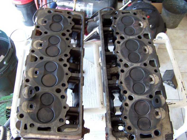

I am building a 6.5 turbo and have available a set of 6.2 and 6.5 heads. Since the 6.2's have larger intake valves, logic would say the 6.2's would be the better choice. Any thoughts?
I know the 6.2 heads I have are 82's. Ran into the clearance issue on another engine. Had to fabricate a 1/4" spacer for the rt manifold for clearance. Will check pre chamber dia.Are you sure you have the early 6.2 heads with the larger valves and not the later 6.2 heads with the same valves as the 6.5? Also, if you do have the early 6.2 heads with the long injectors, you will have clearance issues with the passenger side turbo exhaust manifold. Then there is the issue of the precombustion chambers on a 6.2 vs 6.5. Best bet, stay with late model (2001+) 6.5 heads.
Looks like ak diesel driver called it. Die-checked both 6.2 heads and found a crack between valve seats on #8 cyl. Guess I'll be using the 6.5's. Not sure what year they are, 96 I think.It's not just the pre-chamber diameter, it is also the internal configuration and the throat parameters that make stock 6.2 heads a poor choice for using in a 6.5TD conversion. Pay attention to what @WarWagon said of his experiences turbo charging 6.2's or using unmodified 6.2 heads on a 6.5TD. The man has more experience with 6.2/6.5 heads, motors, blowing them up and what combos work and which don't than anybody else I can think of on here. Using stock 6.2NA heads in an attempt to make a hybrid 6.5TD just doesn't work for the reasons WW outlines above PLUS, you will not see ANY appreciable difference between the early and late intake valves as far as performance, fuel mileage, etc. goes. Been tried many times before, reality proved theory to not be valid.
