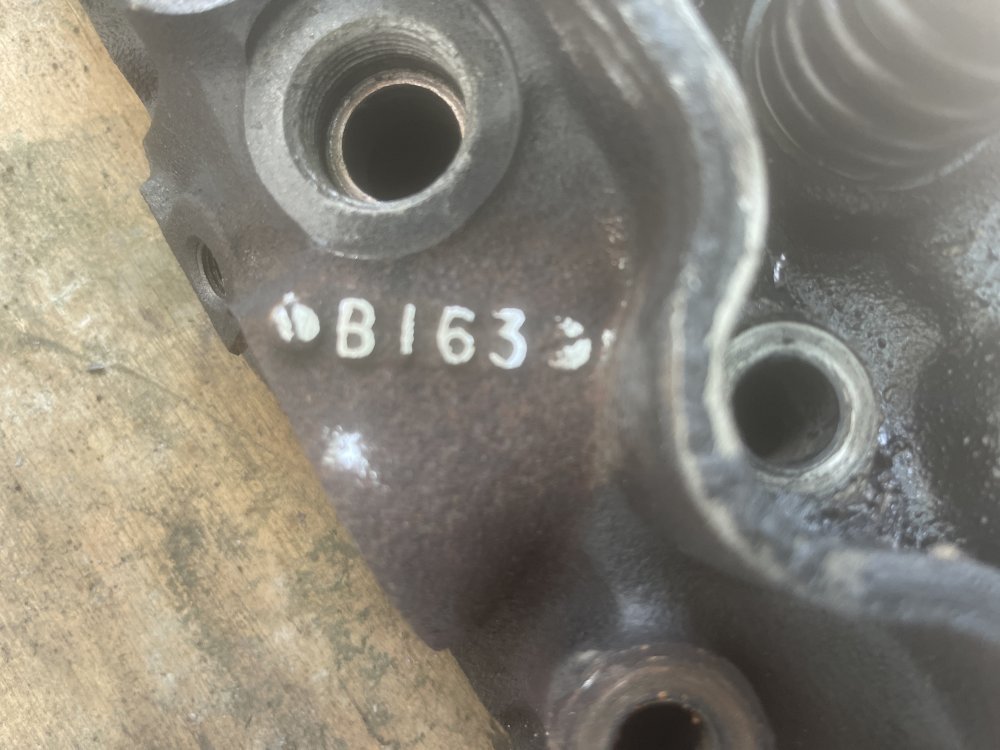

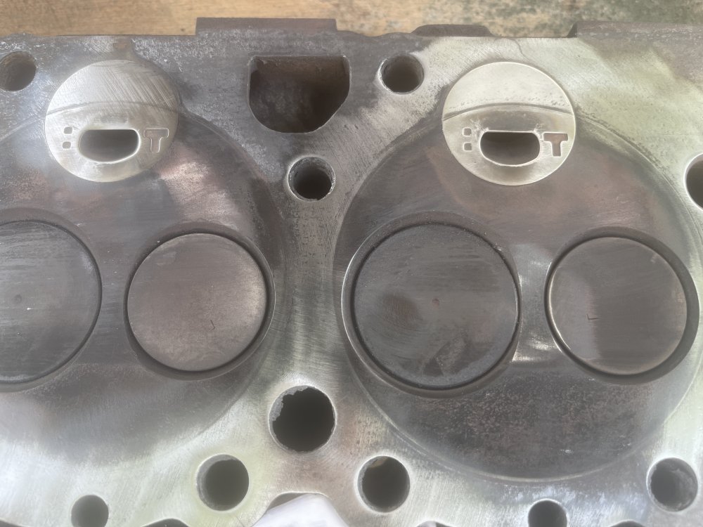

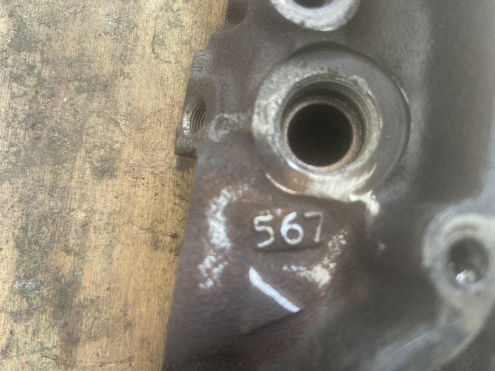

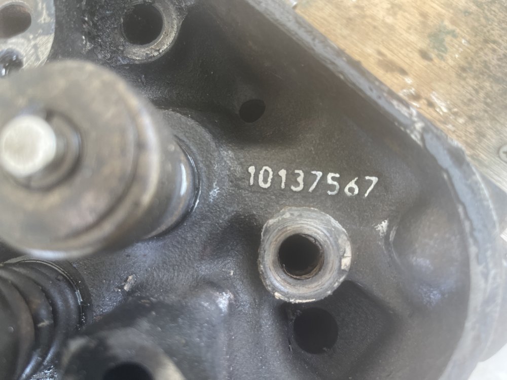

Hey guys, can anyone tell me anything about these heads I have? See photo's. They came off a 599 block from a 1993 K3500 single wheel truck.
