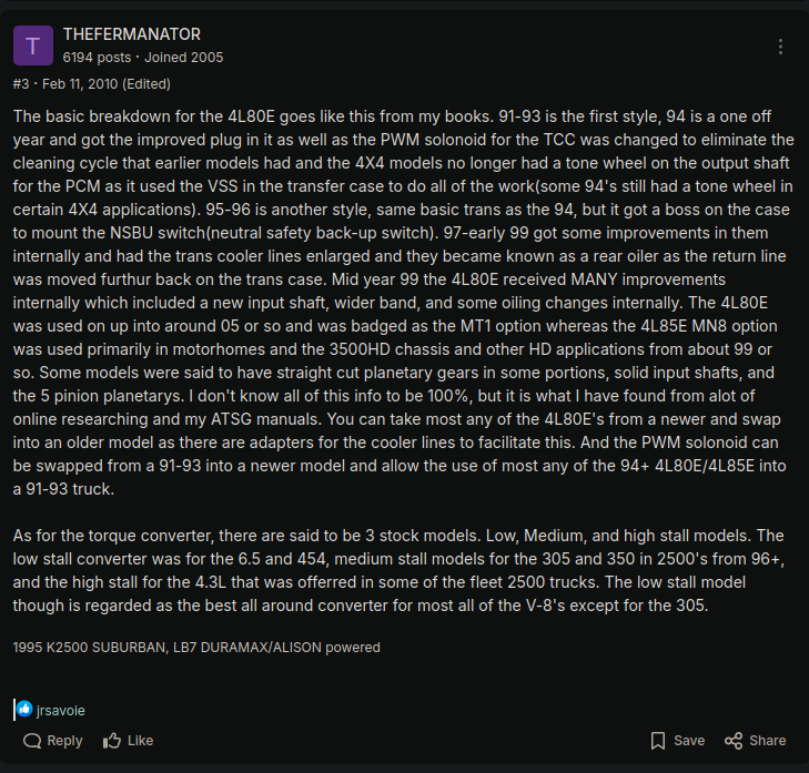

I have read where @THEFERMANATOR has posted the differences many times and learned about the PCS (pressure control solenoid) are different from the 93 and the newer ones as well as the valve bodies with the TCC PWM solenoid cleaning cycle on the older ones. Here is a snip of one or his posts telling the differences..

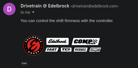

Well I received a response from EZ-TCI on asking for some technical data for the controller....
This doesn't help much given the fact only one gear change is effected. you can't hardly feel shifting from 2nd to 3rd and going into 4th is not felt at all!

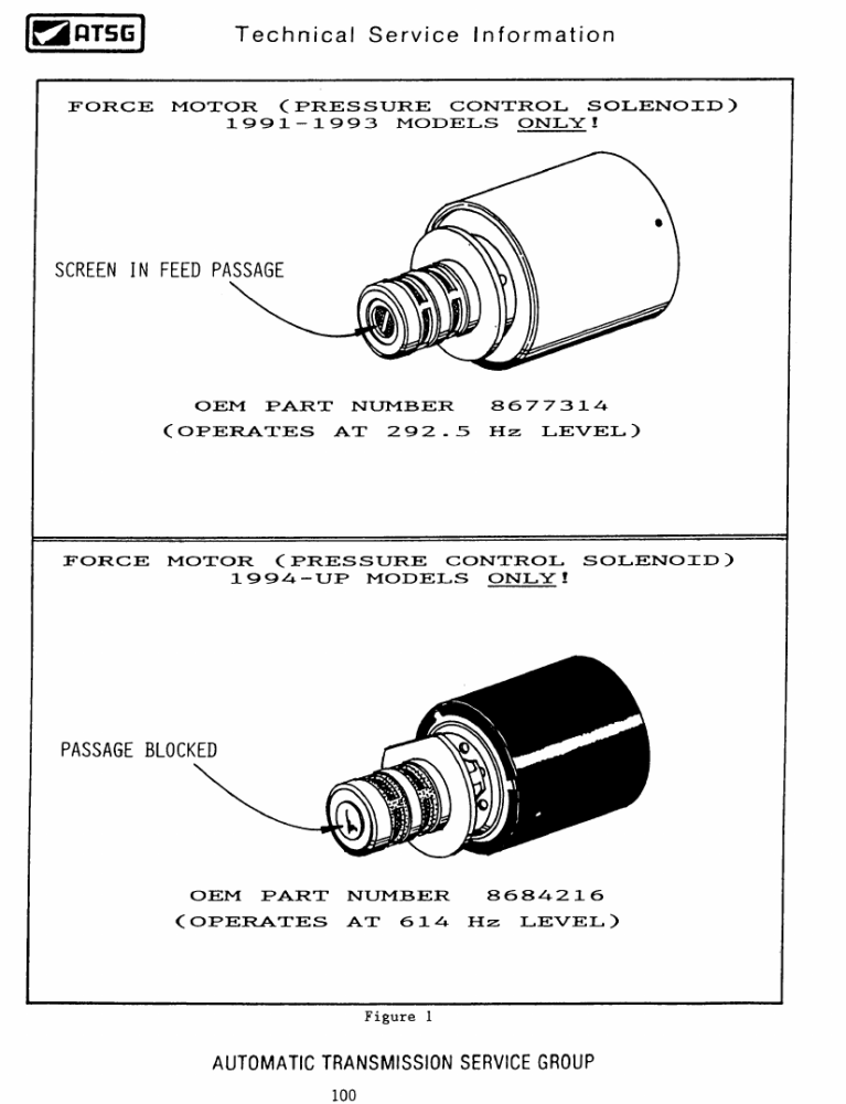

Found a little info on the EPC or pressure control solenoids. 93 used a bosch solenoid which had a screen opening on the end, 94+ used a Holley solenoid which does not have the screen opening on the end. armed with the physical differences now, I need to figure out if the newer style can be used in the older valve body. I also found out how to test all the solenoids for resistance without needing to drop the pan. this my reveal things too.

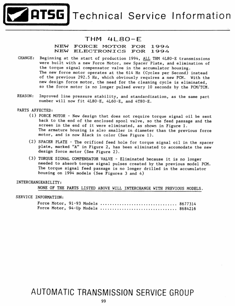

Here is a link to a TSB I found.

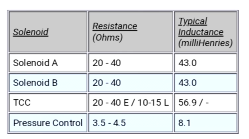

Well, I just got around to doing an ohm test on the solenoids via the trans connector. Here are the results and some extra info.
Solenoid A = 22.6 ohm
Solenoid B = 22.1 ohm
TCC PWM = 11.6 ohm
PCS / EPC = 5.3 ohm
the only reading I found to be slightly out of spec is the PCS. holding the meter probes on it longer it did start at about 6ohms and slowly go down to 4.8ohms in testing it several times. I am curious if the resistance goes higher as the trans warms up taking it fully out of range causing the hard shift from 1st to 2nd.
This is the info I found online for what they should read...

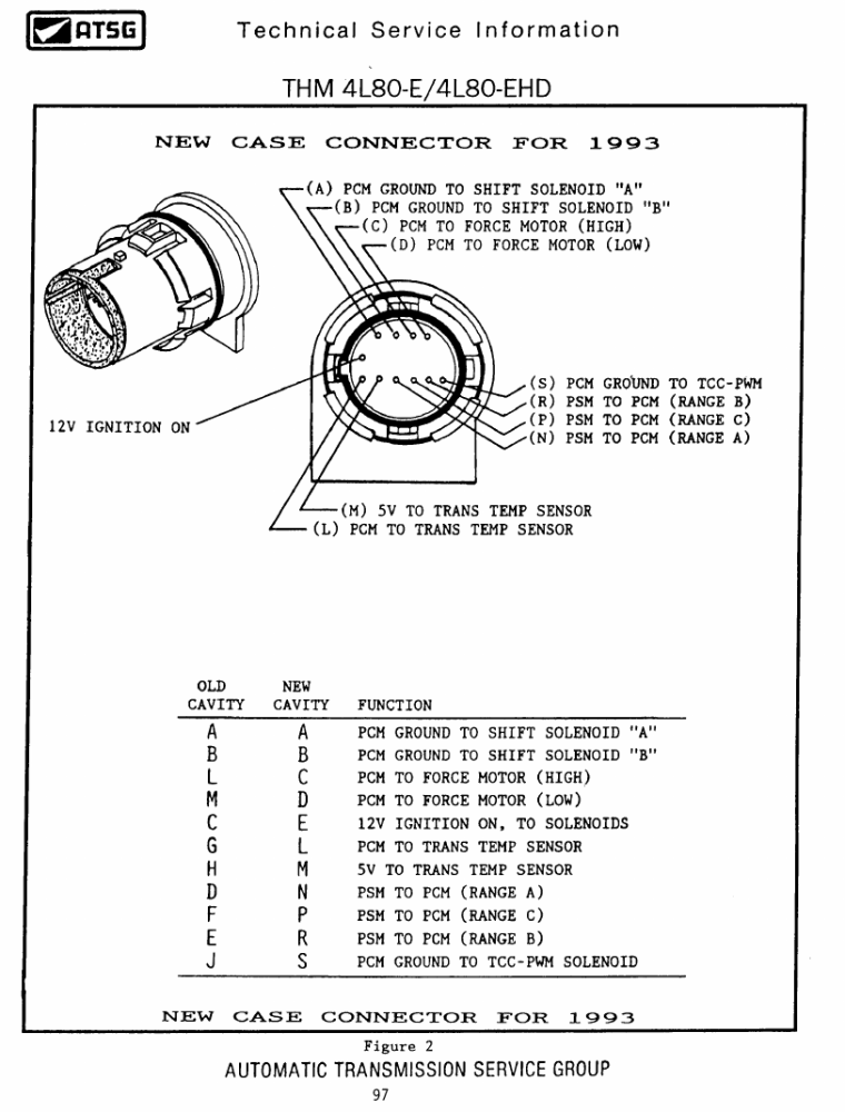

And the connector diagram from the ATSC book...

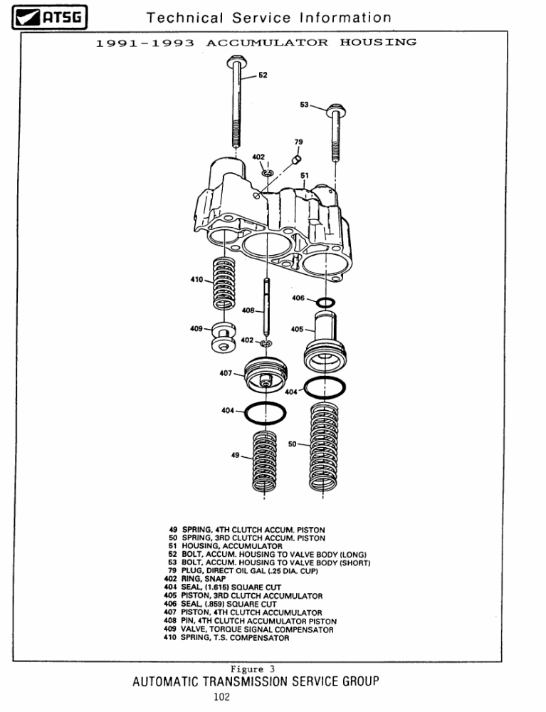

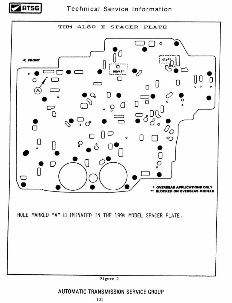

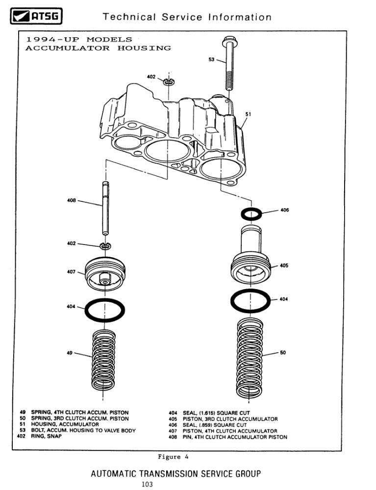

all in all it looks like I will be dropping the pan and replacing the PCS solenoid. I did find out in reading the ATSC manual that the newer PCS can be used but some changes to the valve body need to be done. this is something I am not comfortable with attempting to check on my own. I guess it will all come down to what style solenoid I find in the trans as to what goes back in.
Here is another snip from the ATSC manual on the PCS solenoid and the changes in the valve body.

Just crawled up under the truck and opened the harness on the trans connector to verify the EPC wires were in the right places also probed both on my meter with the key on to see if there wasn't a bad wire in the harness. getting 11-12v from the TCU. also ohm tested the EPC once again while everything was still warm (not fully hot though) and showed 5.2 ohms across the pins. I think the range for a good pressure control solenoid is 3.5-4.8.
this might explain why it shifts fine cold but once warm it gets harsh. just for giggles I might warm up the 95 and take an ohm reading on it too.
I've been dreading to drop the pan on this but it's looking more like I am gonna have to open it up. at least this truck actually has a drain plug on the trans. I might be able to save on the fluid, need to find one of those re-usable pan gaskets if there is such a thing for these older trucks. that way if I need to drop it again, all won't be lost.
Back probing pins C and D on the trans connector revealed 11-12 volts with the key on. if disconnecting the connector allows the trans to run at full pressure (no voltage to the solenoid) then I would assume when voltage is applied it should lower line pressure.
