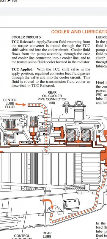

Is there functionality issue from any alteration in volume (flow rate) back into the trans? Where does the line feed to once itcomes back?
From some stuff I read the return line from the coolers should be the rear one and it lubes/pressurizes from the back forward. The older units feed into the middle instead of the back
91-96 has both lines in front, in 97 GM went to the rear luber and moved the return line to the middle of the case. The cooler return flow lubes most everything from the middle back(the output bushing and slip yoke for 4x2's are lubed by the afl circuit). This is why I do not like the reducers at the radiator. GM ended up going up to a 1/2" line for the 4l80e, but the radiator reduces it down to that of a 5/16" line. That's 2 big choking orifices in the flow is how I see it. Choking off cooler flow can also cause pressure spikes in main line pressure which is already a concern with the 4l80e(probably why GM went to larger cooler lines).
