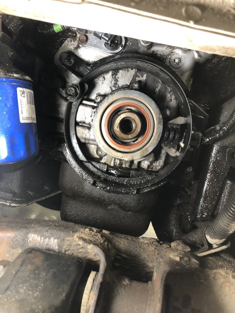

This is on that 1991 Oldsmobile Royal 88 with the 3800 engine. I am guessing that stands for 3.8.
Anyhow, got the H-Balancer removed and behind that, in order to get the CPS removed, this debris shield needs to come off.
It has three stud affairs with knobs on on the ends. Attaching the shield to them studs is a sort of a barrel clip with I think three fingers against the knob.
Has anyone had any experience with these ?
I dont want to just go prying on them and bust the shield so any hint on such a device would be greatly appreciated.

I have spent several hours looking for the answer but to no avail. Tried the changing CPS and removing debris shield behind HB and all anyone wants to talk about is removing the HB and no farther.
The shield. No, I do not want to bust this piece trying to force it. 🤷‍♂️😹😹😹
I googled this - seems to just pop off.
Oh My.
I searched youtube videos and the ones I watched didnt get far enough to show how to remove that shield.
I did try pulling on it but it seemed fairly well stuck on there and I sure didnt want to break it by prying on it with some sort of a prying device.
The Haynes book doesnt even mention this shield.
Thank You so much glagulator.

Yes, that plastic shield pried right off.
I did however use a lot of caution just in case it had become brittle.
Front of engine is totally removed, oil pan also.
Next is the intake manifold and valve covers.
I have no money at this time to make the parts purchase so just taking lots of time and scrubbing, cleaning parts and buffing bolts clean.
The cam position sensor had a very slight mark across its face, find out there is a sensor magnet clipped within a bore of the cam sprocket. That megnetic sensor had one clip that had started to break, the only way to replace that magnet is to do a total tear down of the front of the engine and timing components.
I’m now happy that when I ordered the crank PS that I also got the cam PS and removed it or else within a few thousand miles that magnet would have busted free and left the engine in a no start mode.
