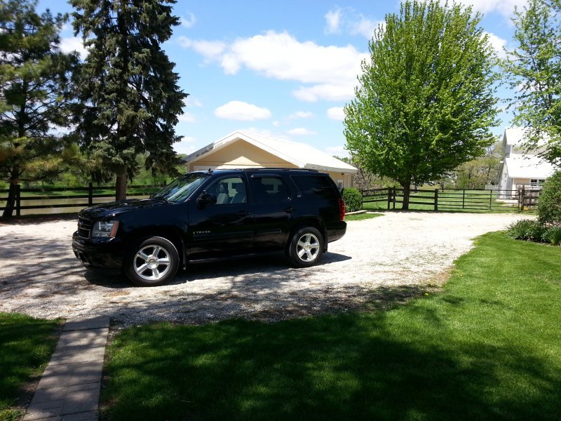

Thanks for all the help everyone. Going today to look at this one up for sale and we'll see.
This is to replace her '01 suburban with a 6.0 in it. I told her it's still worth some more life out of it, but don't have her convinced yet. It has about 200,000 on the clock, neglected, and I destroyed the back interior of it a couple years ago hauling a couple of 6.5s in it like a pick up.
I guess some females are picky about the oil & diesel smell that does not come out of the carpet and back of 3rd row seating for some reason.?. So she doesn't exactly want my opinion on how much I like the feel or power of it, I think the less I like it the more she will out of self preservation of her own ride.
