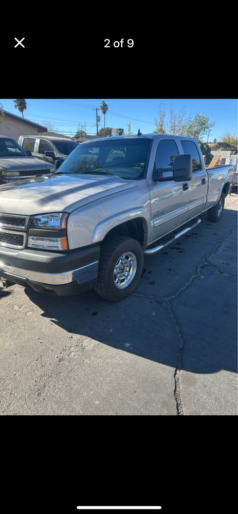

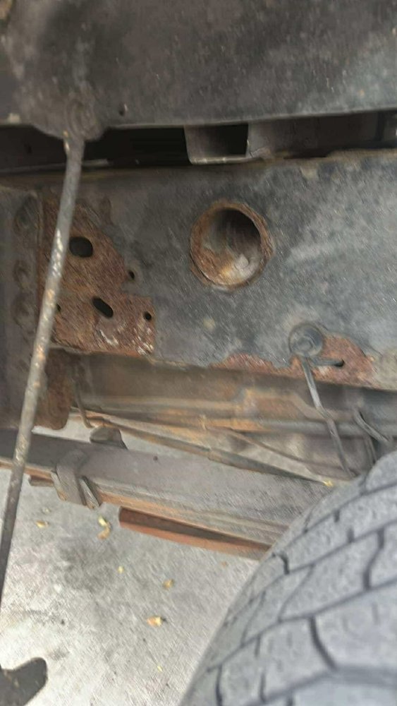

IMG_6659.jpegIMG_6660.jpegIMG_6661.jpegI am looking at a 2006 LBZ for purchase in the Henderson area of Las Vegas. It has 199K miles, owner has owned it 8 months and it was his first diesel truck and is his daily driver. He has since bought a 2020 for better looks. It previously started life in Montana, then Washington before he bought it in Nevada. It has some rust on the frame and he provided photos. I want the input of the forum here on the amount of rust.
It has seen plenty of salt. What does the body look like? Can you pull the plugs in the cab to peek inside of the rockers and cab corners. If you have a bore scope, you can run it into the front fenders from the front to check for rust above the wheel we'll inside. Go from under the hood.
By Northeast coast standards that's not rust and is mint! Literally the springs look new. If that's the worst of it I'd say its in great shape at least frame wise

I have seen alot worse than that, don't think there's any problems with frame strength. Mine has a few rust spots here and there, where that factory wax coating has come off. I'm going to touch it up when the weather gets better.
