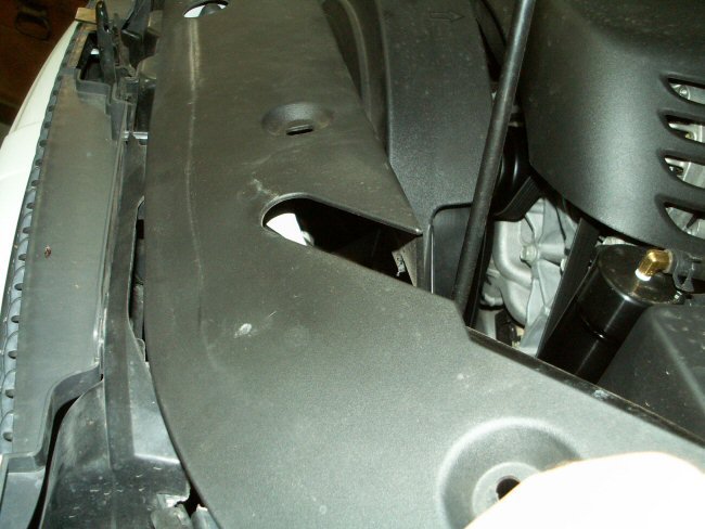

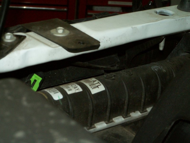

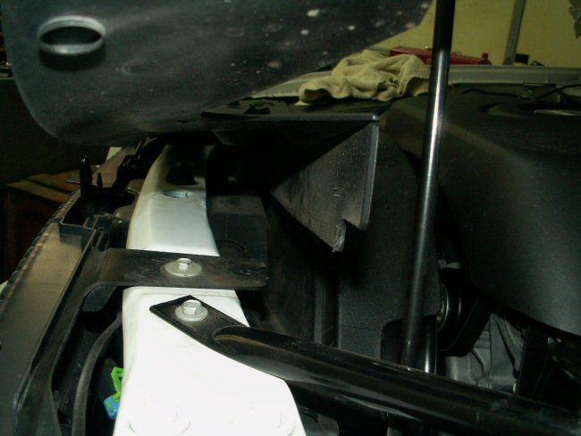

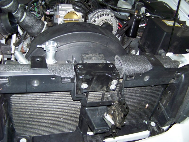

This bodystyle has a massive airflow leak over the top of the radiator that makes AC performance = SUCK when stopped or parked. Fix is large pipe foam shoved into the hole under the useless plastic cover.
Fix with large pipe insulation.
I noticed the catch can and a fancy radiator. Not sure what else... my mind is stuck on head steam pockets for some reason today... That and trying to remember where I put my piston pin retainers before I just order another set. Collecting parts in one area of the garage again so I can hopefully make progress before it snows in Vegas.
That's the Ron Davis built to spec radiator project prototype on the 6.0L Trailblazer SS. And, Yes, a catch can.
Has there been a lot of problems with those trailblazer radiators? Many hummer guys had issues and some issues who own multiple rides had issues from ron davis for other cars, even out of the box failures. Majority say they are good for many years before failure.
EV fan clutches were built too cheap and had lots of failures including internal clogs keeping them from running. The radiator was simply too thin and could not use all the airflow the fan could generate.
