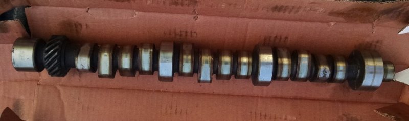

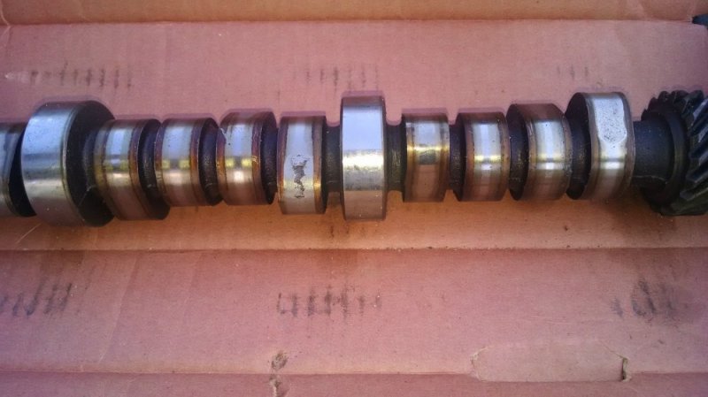

Thought I had updated this. This past Spring the owner had a shop check it out and was going to do a new timing chain as the single roller chain used is prone to stretching. The chain went into a completely different engine!
The shop did a compression test and found low compression in #5. The pulled the engine and found cracked heads, shot camshaft, worn valves, cracked block at a head bolthole. The owner says he used Mobil 1 engine oil since new. Again this tows the scrap metal in our extreme heat and had around 250K on the engine. IMO needs to change the oil more, use a thicker oil and add a zinc additive. *cough* Or get a v8 or a diesel for towing... The return trip empty will show a vacuum leak in the system as the doors direct air to the floor from the lack of high throttle vacuum. He is using Amsoil now. I have UOA going on for the truck to see if the oil is failing or just was high miles and too hard work for a V6.
