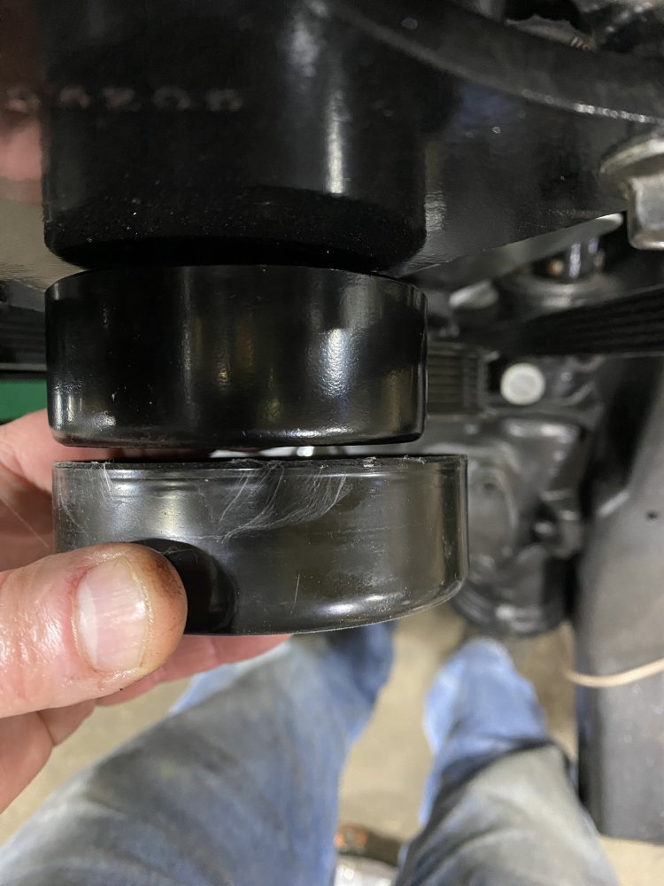

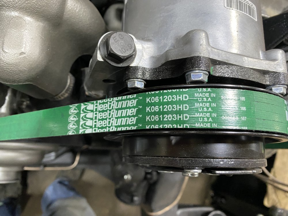

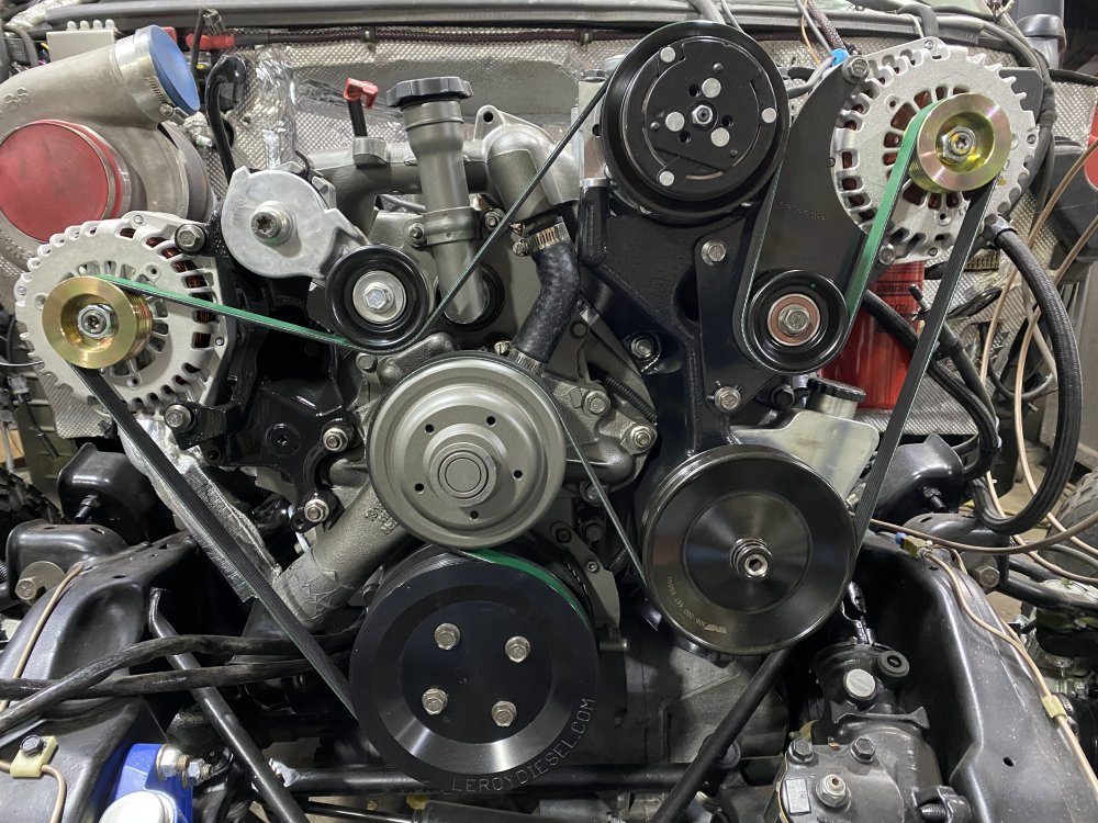

Finally have the accessory drive figured out. I tried a few belt sizes to figure out the length that would work with my unique setup. What’s unique is I have 2 AD244 alternators, I have the pulleys to get the alternator RPM correct for the 1994 tach and I have the AC compressor spaced up 6mm so the Sanden compressor clears the mounting bracket. The best combo I found was to use a smaller tensioner pulley in place of the correct idler pulley and the corrext belt for the 1998 dual alternator setup.

With an alternator setup like that You could convert that truck to a back to the future unit. 🫣😹😹😹
