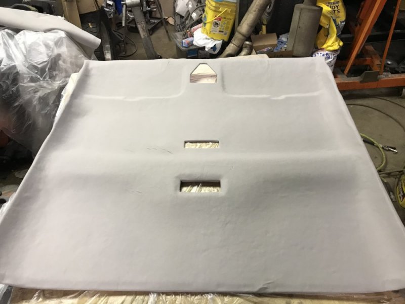

When I did mine, I started in the middle and did not spray the whole thing at one time. I laid the cloth out, then folded half of it back - and then worked my way out.
That headliner adhesive from O’Reilley is pretty good stuff. I also used it to glue some aftermarket seat covers down to my worn out seats. So far it has kept them tight and looking like a full re-upholstery job for over a year and a half.

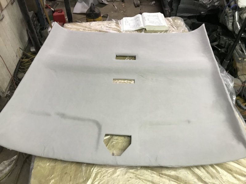

Yeah in hind-sight I also should have bitten off smaller chunks. In his video he laid the fabric down, folded it back halfway and then sprayed that whole half. I would definitely do smaller chunks in the future.

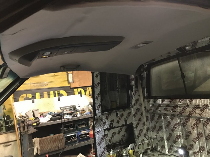

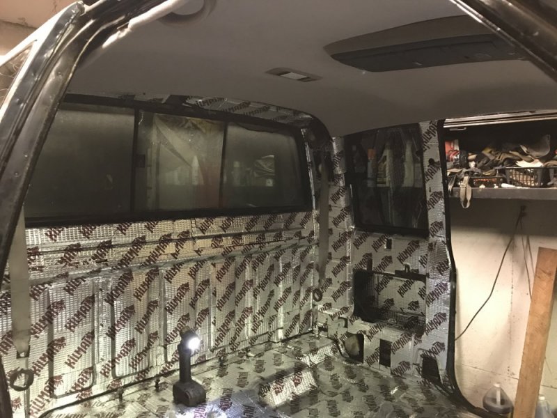

The headliner looks better this evening, but still not perfect by any means. Oh well. I wired in the harness for the overhead console and got it and the headliner installed. It doesn’t look too bad once installed. In fact, the darker gray console stands out more than the wrinkles.....oh well. I couldn’t get great overhead pics because the camera on my phone won’t stop shaking at anything over horizontal.

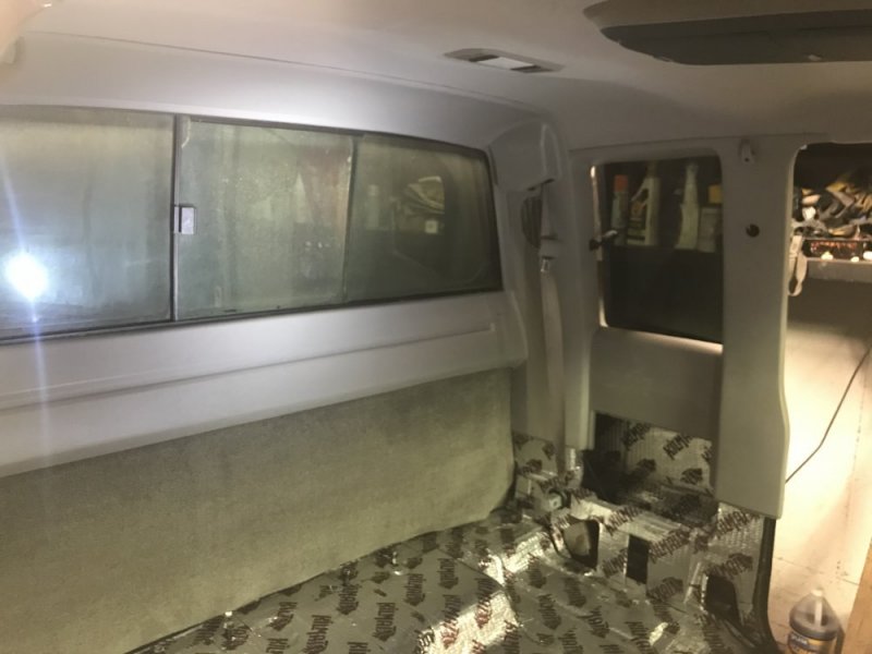

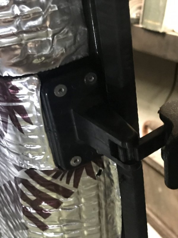

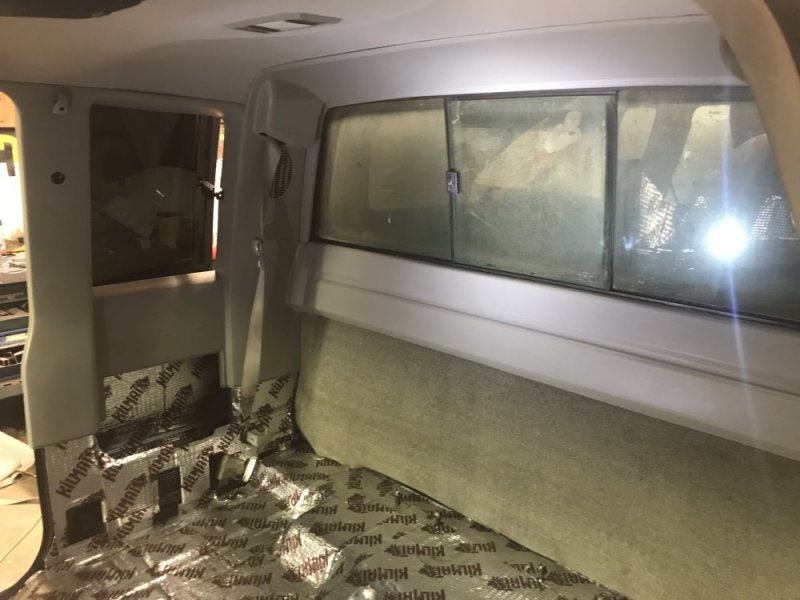

I had removed the rear quarter windows so I could have them professionally tinted. I had to order some 4mm flush rivets from McMaster. Then they could get reinstalled.
After much scrubbing I got some of the back panels installed. It’s satisfying seeing 25 year old plastic come clean both inside and out and then get put back in place.
This weekend I’ll be cleaning the carpet and then once that’s installed I can get more of the panels put in place.
