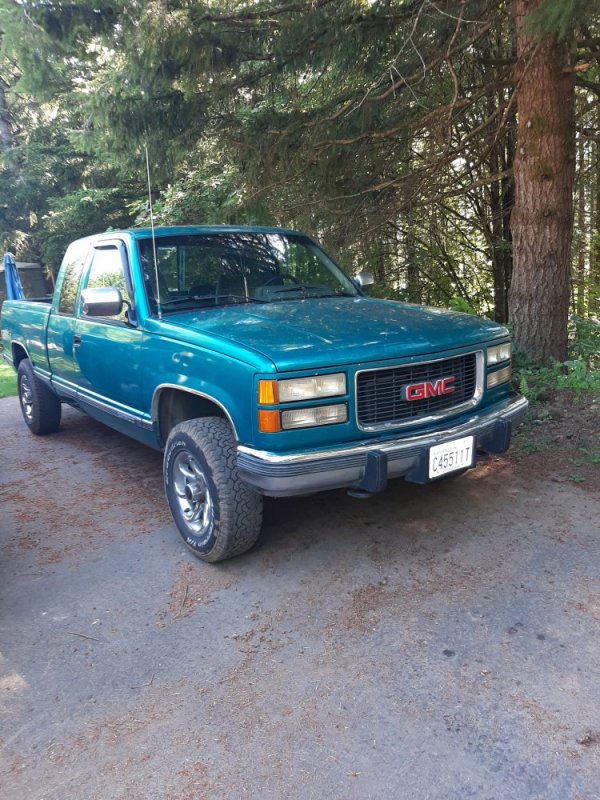

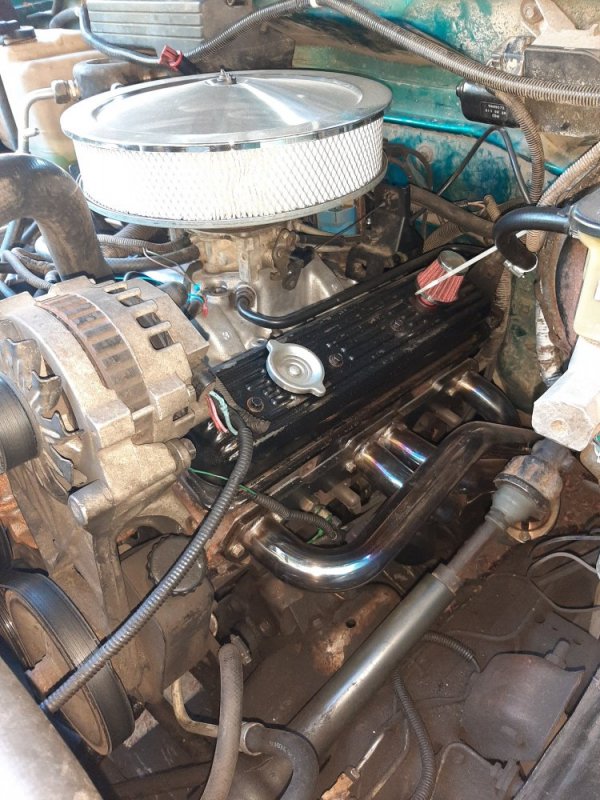

New to the site! I've got a mild build 350, its in a 1994 GMC sierra. Some stainless headers and she runs pretty good. Burnouts on command are pretty dang nice. If there is any interest in the modifications I'd be happy to elaborate. Looking to buy a 6.5 diesel version of this truck, or even trade with cash on top. Looking to use the green pump at the gas station lol. How does the 6.5 Detroit compare to the 350? Pros and cons would be amazing.20200722_164841.jpg20200722_164812.jpg
