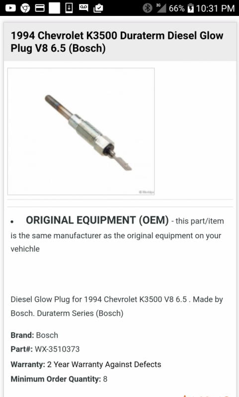

Gottca. The pump that is in the truck is a DS4 5521. From what I understand, it is the newer DS4? What's the easiest way I could check the timing on it? I have a huge shop full of tools but not much for the diesel world. The glow plugs I am running are new Bosch Duraterm WX-3510373. If done a resistance check on them and a voltage test on all leads and all seems well. Have not done a compression check yet but I will tomorrow when I install the clear line on the IP and check the chain stretch. What are good compression numbers I should be looking for? 400psi after 4 revs?
These were recommended to me from a diesel head buddy of mine who has a 2500 with a 6.5.

My appologies. That part number is for the whole kit not just the glow plug itself. This is the part number on the individual box of glow plugs I installed.
0250202126
