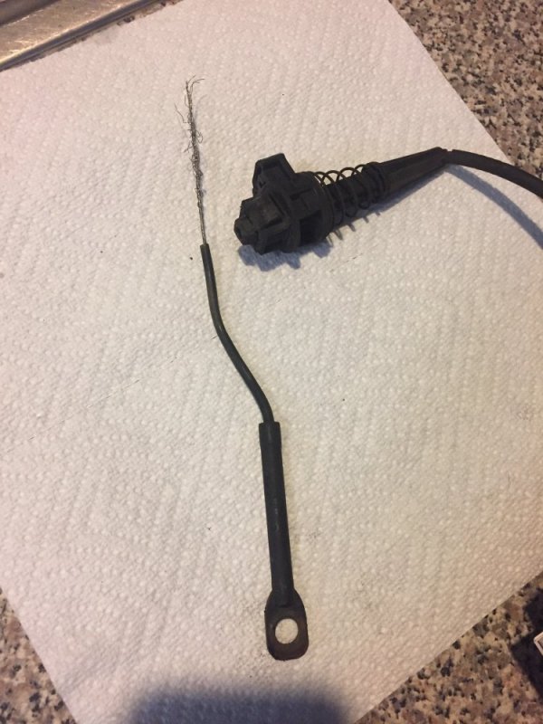

Brake lights stuck on? Do the brake lights work now? Random failure of the brake switch is common on our rigs. Next common failure is the cruise switches on the turn signal stalk. Of course, you check every fuse. Rigs our age: the fusible links can fatigue and break as well.
What got wet in the hard rain? Anything referenced above? Water in the turn signal cruise switches would make sense to cause trouble.
