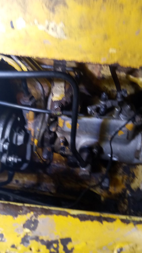

I have a 1975 Ford 3550 backhoe with a cav4 pump.
No start today.
No fuel at the first injector.
No fuel at the injection/ injector line I Took loose at the pump.
I have fuel at the bleeder on the side of the pump.
I read about another bleeder, but haven't found it yet.
I know nothing about these. Even though I've had it over 20 years.
Any links would be appreciated.
What all can I check before giving up and removing the pump?
Will these run if the return line is plugged?
I had that on a couple of 6.5 diesels

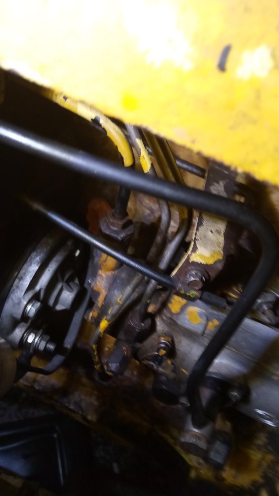

The IP has 2 lines running to it from the fuel filter.
One to the front and one to the side.
I'd like more info on the line to the front.
I'll get a picture when I get outside.

On the inlet line on the pump, there's another hex, that the feed line screws into.
I couldn't pull the feed line when I unscrewed the fitting.
Might have just been stuck.
What happens when I loosen the fitting that the feed line screws into?
What's under there?
Getting ready to try again. Missed yesterday all together.
Not feeling a whole lot better today.
Is it possible / ok, to add a lift pump off a 6.5 diesel ahead of the fuel filter?
To augment the gravity flow from the fuel tank?
I have a 50 micron inline filter I could install ahead of the lift pump.
I removed the inlet line to the pump. I have fuel there.
I pulled inlet connector and lifted the spring out. Everything looked clean there.
It says a sticking metering valve will usually stick in the off position. Preventing the engine from starting
I'm wondering if that might be my problem.

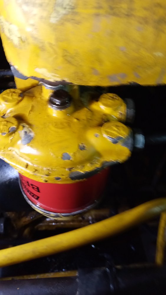

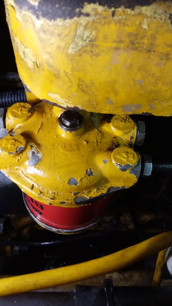

On the fuel filter there's arrows indicating in and out.
The line on the right has always been in the out port on the right and the plug in port with the arrow pointing in.
I swapped the 2. That's the return line from the injection pump.
It's been the other way forever. From what I read, it will run that way.
After I swapped them I did get more return fuel to the tank. Still just a dribble.
The return from the injectors is clear.
Can anyone verify that the way it's hooked up now is correct?
I switched the line back the way it has been since I got the machine.
From.what I figured out, the only difference is the in arrow runs the fuel back through the filter again - that sounds advisable.
Sounds better than sending it right back to the injection pump unfiltered, even though it just came from there.
