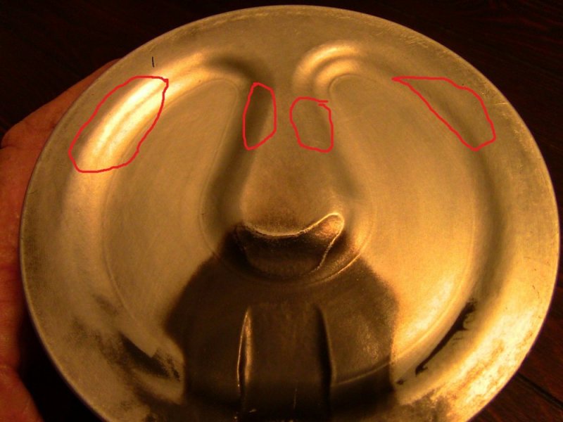

The CNC program is being written to include the valve reliefs but could be omitted, the reliefs aren't going to take much away as they will only be around .050" deep, and they will only be seen on the edges. My thinking is if someone uses a timing chain or carbon build up over time this would prevent the possibility of a valve strike.. and not having them wouldn't change the cost any..
That looks similar to others I've seen. I've always wondered how that change in the swirl bowls affects things. I've always thought about shortening the rods but have heard that the flat area not in the swirl area was detrimental. Anyone actually know anything about it or are they just assuming.
I think it needs the "quench" area around the outside of the piston. These are the Kennedy design, and I do have his permission to copy it.. I believe this design removes most of the "piston rock" in the cylinder making for a quieter motor by the piston not rocking as much by distributing the flame & pressure around more of the piston top..
As far as I know no one has proven or disproved the design..
I have consulted diesel engine builders about the design and the valve reliefs and all tho they are not IDI builders they have the same thinking I stated above so I'm not changing it any other than ccing to get a confirmed ratio...
If someone has a better design bring it, I'm open to other thoughts..
