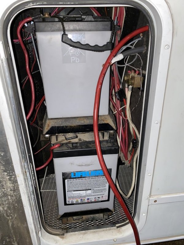

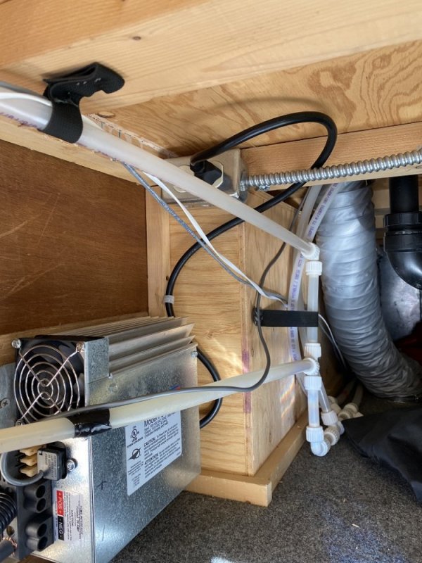

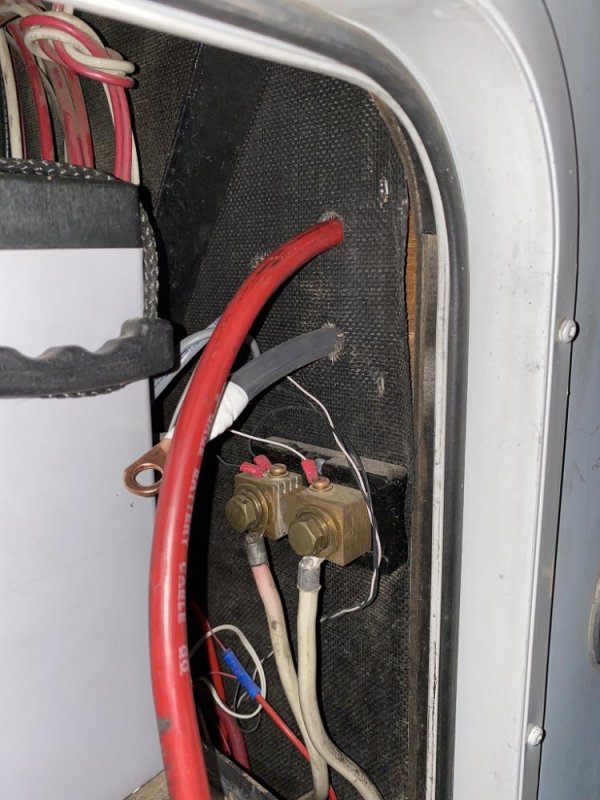

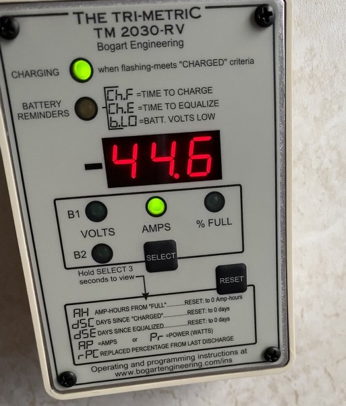

Here is my RV project moving the 60A charger/converter closer to the AGM batteries with thick wire. 44.6A is getting near the limit of the 60A converter limited only by the AGM batteries not being discharged that much. That 30A fuse would be T O A S T here.
