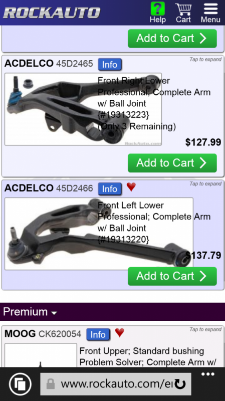

SmithvilleD did complete his install of the GMT 800 brakes and he was using the GMT 800 LCAs (see post 14 for picture):
http://www.thetruckstop.us/forum/th...00-brake-conversion-tie-rod-discussion.45012/
He also posted in your linked thread that it was his intention to install the GMT 800 LCAs.
He also completed the swap of a GMT 800 Corporate 14 rear axle with disc brakes. Based on his input we have a GMT 800 Corporate 14 all prepped for installation on my son's '94. Just been a bit busy to get to it, but the time to do it is soon.
