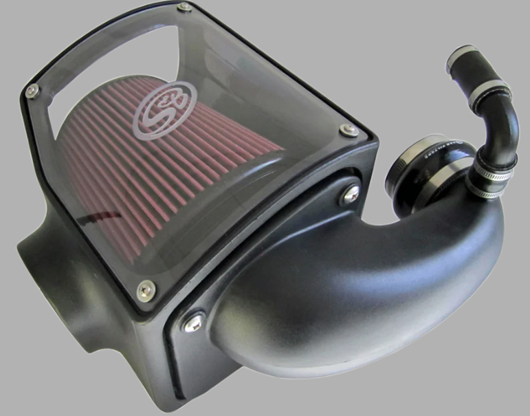

Has anyone used this combination successfully?

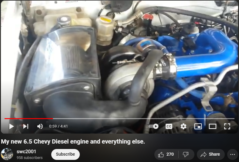

I saw this where a guy has one but I believe he said this is an A-Team turbo so I suppose the center axis of the turbo is closer to the stock height.
I'm having a hard time finding much on the air filter box side of things when a HX40 is used.
The air box @Paveltolz is using seems to allow for some deviation based on what the pictures seem to show that he's posted. I don't think Heath's box is available any longer though.
Any thoughts?
It could probably be adapted by using a reducer silicone coupler. Not sure what the size is on the S&B elbow but maybe a hump hose coupler could still fit the HX40 axis
Another idea would be to fab a different outlet if the plastic plate with molded elbow can be unscrewed. Make a new piece out of aluminum or steel and weld on a 3", 3.5", or 4" joiner so a silicone elbow can clamp on and rotate to fit the larger turbo
I think if you post a few pics of your turbo with the stock filter box might help, side view, front view, etc.

Mine and this example of SoB's air box are one and the same. It differs only in that Heath's didn't have the option to remove the rear and open the back. I guess the reasoning for that 'improvement' was/is to allow for improved hot air induction making the term 'Cold Air intake' an oxymoron. I don't know. It does quiet turbo whistle very well.
To secure the unit to the fender, there is an oval cut hole under the filter to allow for shifting the assembly a little left or right. Once you line up the horn with the turbo, you can then take advantage of the play the silicon coupler allows and the hole in the filter housing to snug things up in the alignment that suits your particular turbo.
I've run it with a GM-8 and an ATT without issue. I'm thinking SSForce may have run it on his HX-30ish too.
FWIW, the CDR return is a royal PIA. It keeps slipping off the plastic horn because the hose is hard/slick rubber and the attachment point on the hrn is slightly conical or, wider at the bottom than the top. Results: tighten the hose clamp as much as you like...it'll slip right up and off. I modified things and got rid of their POS 90* set up in similar fashion as the video's author.

I have 9-1/2" from the inner fender to the wastegate actuator on the turbo. Here are a couple photos of the area I'm working with but I didn't put the factory airbox in place.
@Paveltolz do you have a width on the box itself?
Solving for "?"
The width of the air box is 9 1/2" so, without the OEM plastic air ducting inserted into the fender's opening, it just might fit. It sits on the inner fender in a slight incline so the side against the waste gate controller isn't plumb so it is canted a few degrees.
Kind like the line you drew showing the 9 1/2" from fender to controller.
You can always send it back if it doesn't fit.
Thanks. The 9-1/2" is from the fender. The snout piece is disregarded in that measurement.
Does anyone know the part number for the cone paper filter we see in these? I guess it sounds like I'll be making my own box.
With the K47 air box and a mechanical wastegate on the HX35/40 I'm able to get both to fit using the stock exhaust manifold
I was leaning toward that. Trying to find another K47. I sold the one I had several years back. Can't recall why but I guess it doesn't matter at this point.
