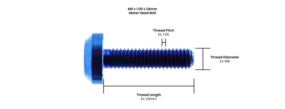

just to be clear, I myself did not know this until getting into the parts side of things and I'm sure others already know this, but here is how bolts are measured. from under the head to the end of the thread. just sharing for others.

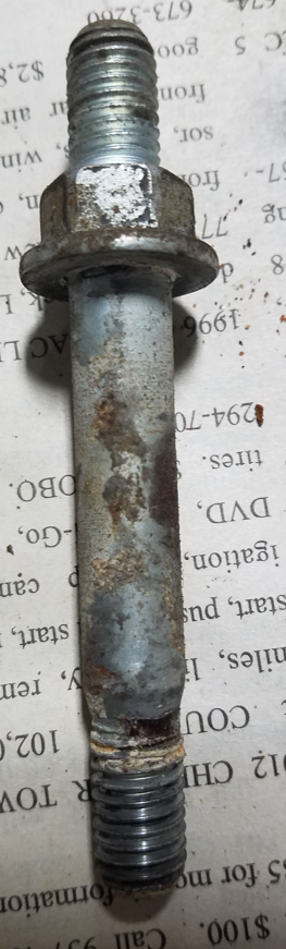

I never thought of using a stud in the block for the starter brace. As much trouble as I have getting my hand in there to start the bolt, I will be trying that when I finally get to installing the starter on the 94.
I was amazed to be told the 1/4-20 stud in the starter was missing.

Yeah the stud on the back of the starter being 1/4" I think should have been at least a 5/16", they shear too easy. since installing a Powermaster starter on my rig, I haven't had any issues. I think for the design and lighter weight there should be less stress on the rear stud and bracket. Though I ended up making a bracket that's more stout anyway.
I’ve never tried the power master starter but I hear they are really good.I’ve bought the aftermarket gear reduction starters on eBay for my 6.2/6.5 engines which have always proven to be good.Both my trucks also use new acdelco battery cables which I’m pretty happy with.
Your right about the 1/4” size stud being too small.It should have been 5/16 indeed.
