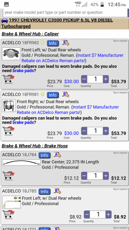

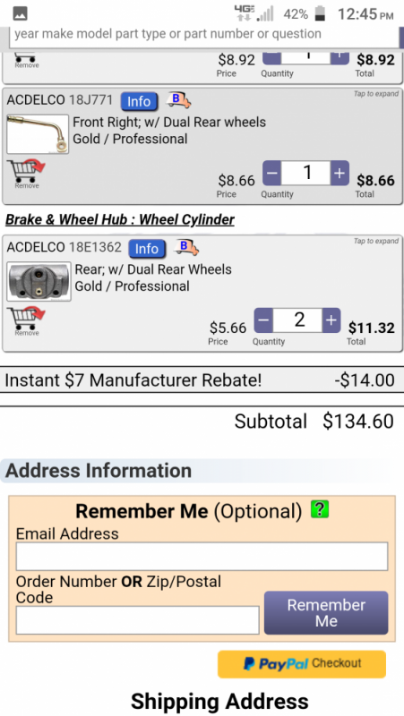

Back to being serious though..I just thought of something... The front brake hoses...I know if there damaged they fail right? So that got me thinking.. the ones that are one the truck always seemed to short.. when you jack up the truck and of course the wheels drop down lower as the suspension extendes by the time the tires are off the ground those hoses are stretched tight to where they kink where they go into the caliper.. do I have the wrong hoses?
I do believe so. They should not stretch like that, unless the lift has been modified.
All of it's been replaced..hydro boost.. MC.. calipers...wheel cylinders pads drums, rotors ,shoes ,hoses
