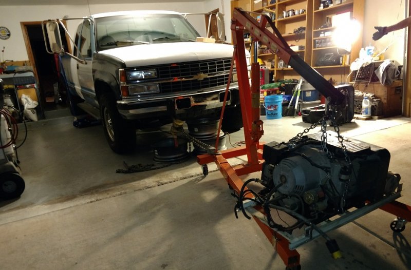

*Portable... Yeah right. Just for hook up purposes it's 'portable'. File photo:

It's rated at a sky high 14KVA for motor starting. Engine is rated at 14HP at 1800 RPM (and 25 HP at 3600 RPM it won't see.) 27A at 240v. This is why you move it with a cherry picker...
