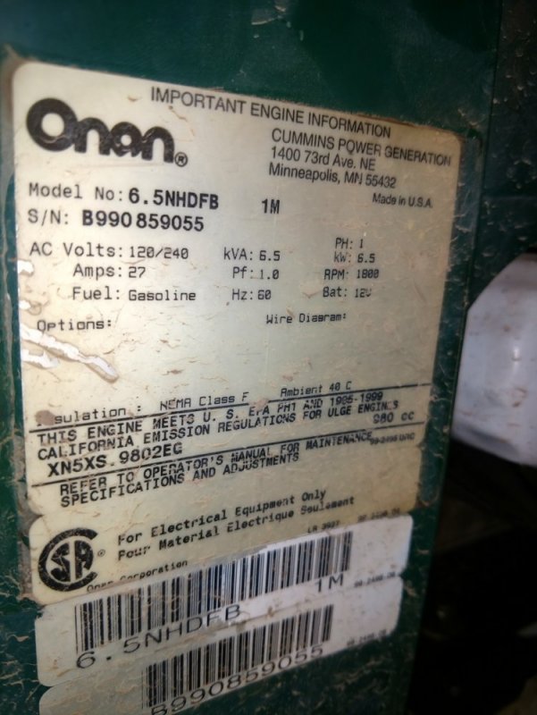

Not found out if it's a boat anchor or a gem at the moment. Sticker says it's a 120/240v Single Phase made in 1999. ~2593 hours on the hour meter as it's a foggy lens now. (A lot of these are a 3 Phase setup that's not as useful.) Regardless this is why you shouldn't lend me your SUV. Patch is down for the count with a leaking injector body, but, is still useful. Did I mention I have a steep driveway? I will mention that a 6500w Commercial 1800 RPM twin cylinder Onan is slightly beyond two people carry heavy esp. with the included pan and mounting tray. No you don't want to know how I loaded it and made the skid marks.

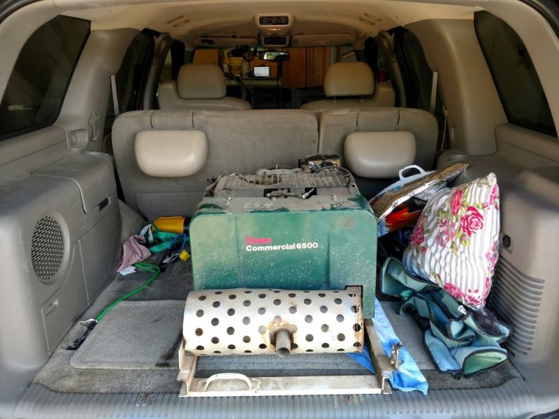

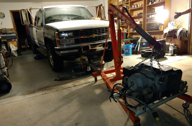

This is how I unloaded it. My Buddy and I made a half-hearted attempt and he asked if I was going to say "Uncle" first? Then my buddy suggested I make use of the cherry picker. Patch was used to make sure it didn't go down the driveway in a 'we should have filmed that' sort of way. Stepstools, not rims.

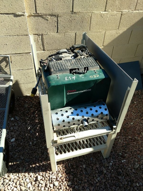

Muffler bracket busted in half, worn at the break, and a couple bolts into a adapter loose on the exhaust. The cage on the muffler blocks the clean out plug and needed 2 welds. So a friend welded the bracket and muffler cage. Painted the muffler with header paint.
One of the base to frame bolts is pounding the muffler bracket. Not at the broken spot.

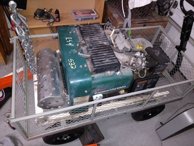

So I need the engine lift back... Dropped this on a wagon. Still needs a fuel pump, brush access cover, and "winter" carb ice heat tube. Muffler fixed and painted with high temp paint.

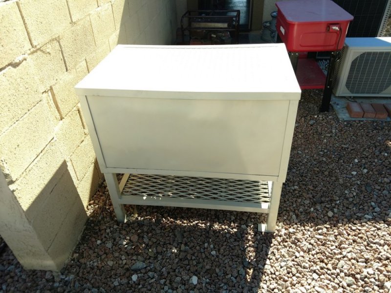

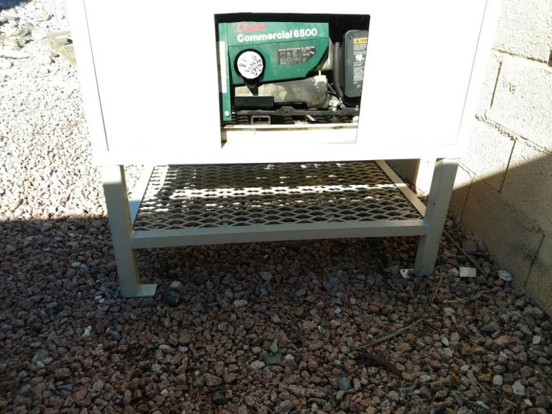

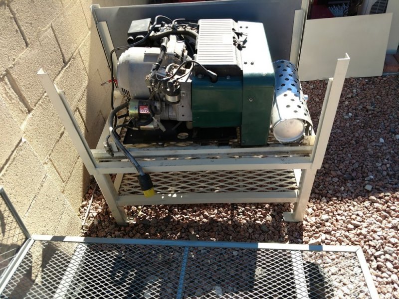

So "Doghouse" time!

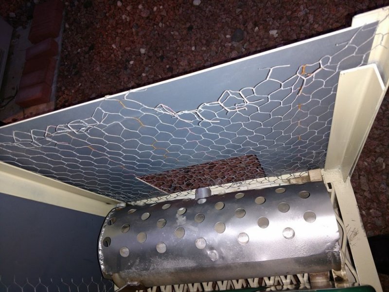

Welder buddy finally made time to do this for me. Keep in mind this is a vacuflo cooling system that blows hot air down. I may need to put a deflector under it to keep hot air from coming back under the suction side as the table is just a grate.

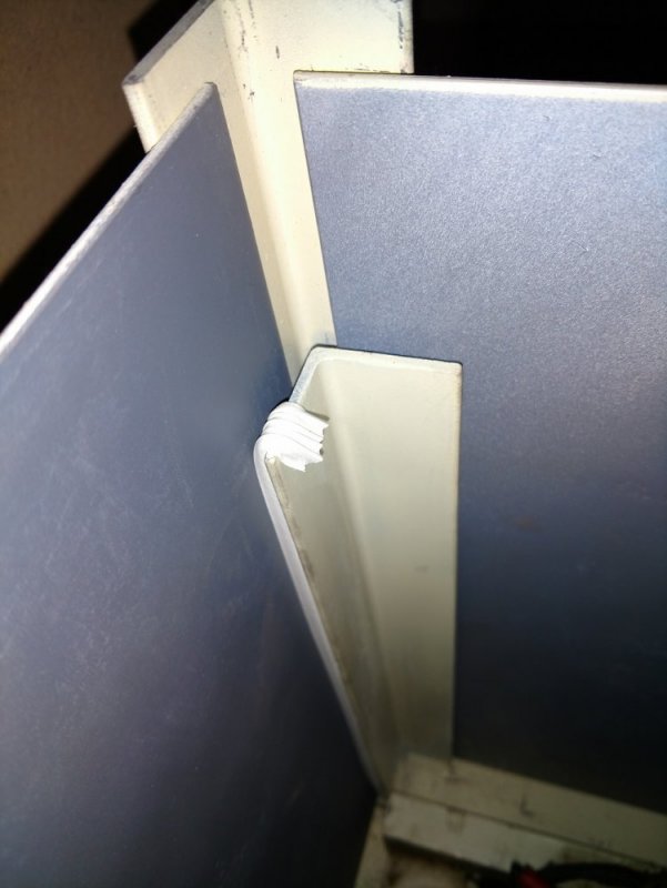

Detail and rattle stop being installed via hardware store door gap seal.

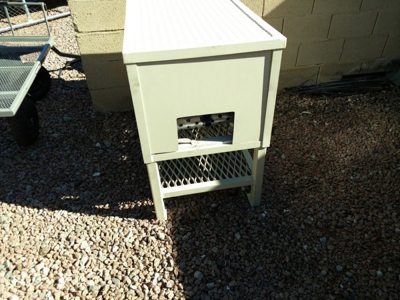

Keep the critters out. Both Openings.

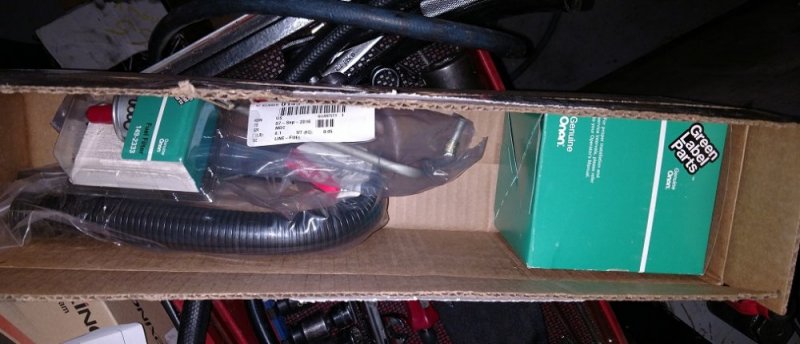

Bag of parts for it:
Maybe a new carb as it was the cleanest part on it, but, had filthy air filter. So maybe just retired it without trying to fix it. Or took new parts off for another unit.
