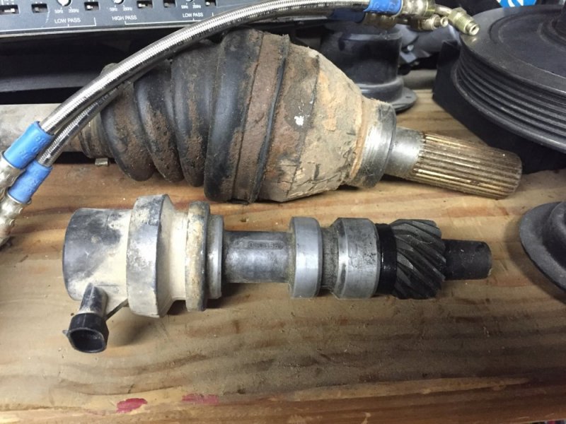

    Yes, you need an ESS: Engine Speed Sensor. It takes the place of your oil pump drive/ vacuum pump unit and has a 2 wire output that can wire straight to a tach.
    I'll post a pic when I get back to my house after a bit.

    Seriously Will?! All I need is a speed sensor to run the tach!? That would be too easy. What type of tach would it run? A factory diesel tach? A stock gas motor tach? An aftermarket one? All of the above? Is that sensor from a 6.5? Do you have one in your HumVee? Thanks for checking.

    My Hummer uses an Autometer as the factory tach. It's a 2 wire tach, that ties to a juction for signal from ESS and feeds my TCM for the 4l80e. Most aftermarket tachs need to be calibrated after install.
    Post pickup trucks use a feed from the cs 130/ cs144 alternator- I can't remember which wire- any help someone? Adding just the wiring might be easier yet.
    You can also get an external pickup that goes on the outside of an alternator. Those suck- easy to bump and mess up.
    ESS:

    Thanks for the photo Will. I see those drives are pretty expensive to purchase. Anywhere from $250-500 bucks. If I could find a used one for $50 or less, I would do it, and use the 2" Autometer tach, to fit in my lower left pod. If I can't find one reasonable, guess I'll have to go to the alternator.

    ESS look junkyard, Craigslist,etc. I have never heard of one wearing out. No way would I pay $250 for one.
