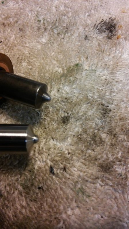

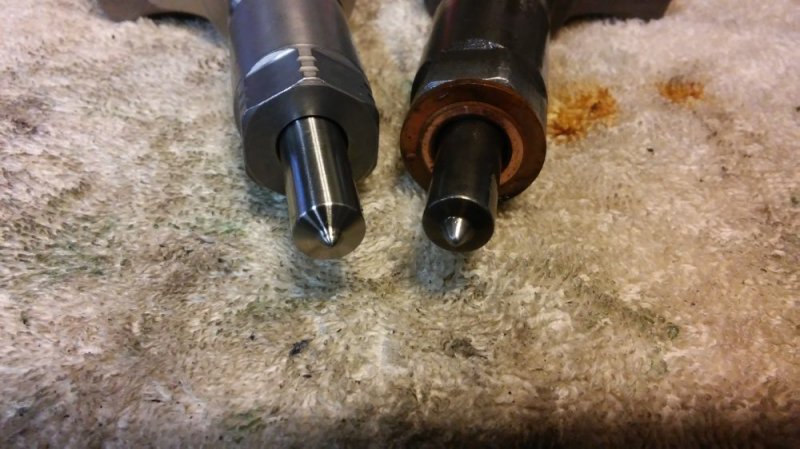

    Finally getting these put in. Made an interesting observation of them. The stock vco's have the orifices up high on the taper and all on the same plane to inject at the same angle. The sacs have a much smaller tapered tip and have the orifices split on 2 planes. I couldn't get a good picture, but you can definately see an orifice up high, then one out the taper so that 4 are high up and 4 are out near the tip of the nozzle. I'll post comparisons pics, but they don't show up very well, and I'm not about to pull apart one of the new ones just so I can spray test them to show the difference. 1228161657.jpg 1228161658.jpg

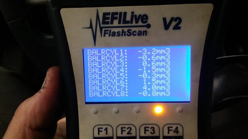

    1229161852.jpg Got the new injectors in last night, and did not get the best of results. Of the new ones, I have 2 that are borderline right out of the box with a fuel smell at idle. No hazing until I drive it, but not a happy camper right now. Called Lincoln, and they said that they don't do the sac's in house, and everything about them has to go to s&s. So I'm going to recover over the weekend, and try and pull it apart Sunday to send them back for testing.

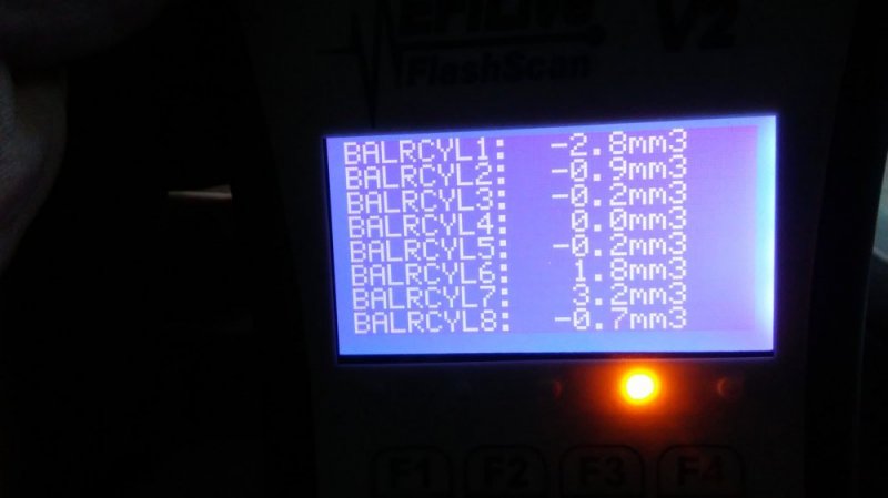

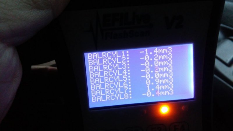

    Need to update this thread. I decided to adjust the tuni,g before going back into the engine, and I'm glad I did. These sac's are SENSITIVE to tuning. I'm not the happiest with the results, but I can definately live with them. Rail pressure, timing, pulsewidth, and getting the displayed fuel rate back to where the ecm wants it at idle made a world of difference. I'm still pulling fuel out of my tune trying to clean it up to my liking, but it's night and day difference in how the engine responds. It lights the turbo off like nobodies business, and pulls like a friggen freight train.
    Here's what I ended up with after working the tune over some. Got the engine smoothed out now off idle, most all the grey hazing is gone, and the heavy fuel smell is cleared up now. Top is in park, bottom is in gear idling.
