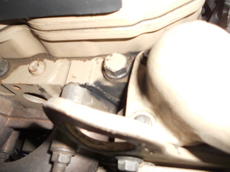

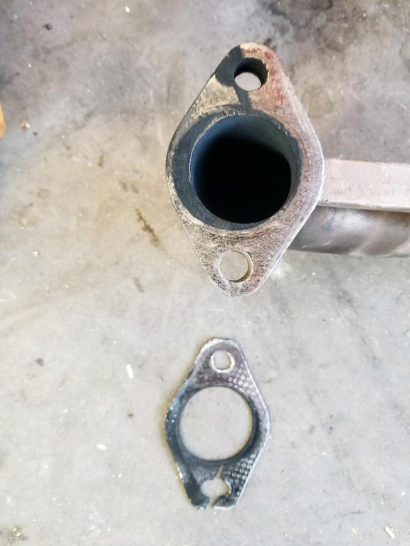

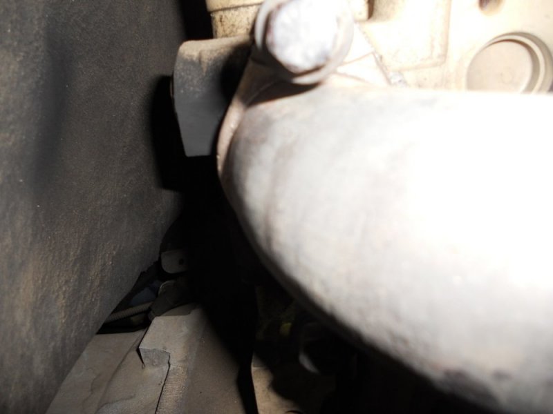

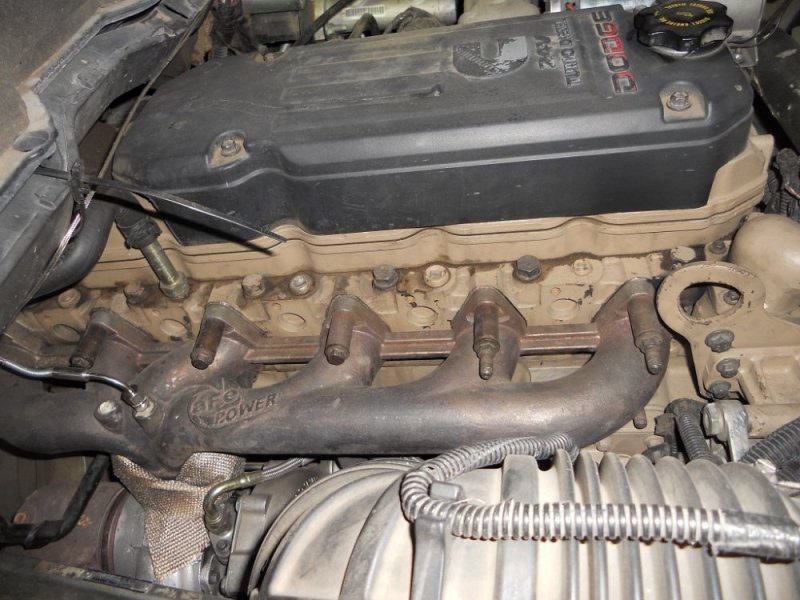

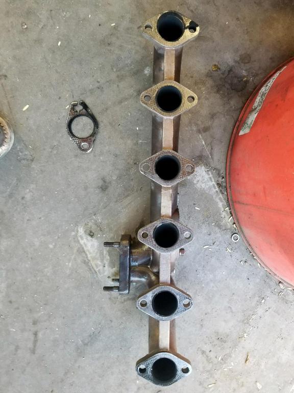

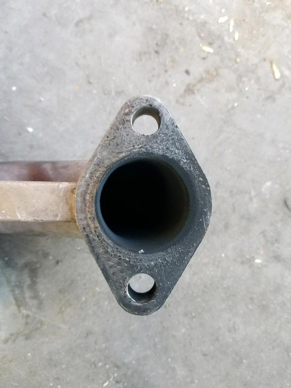

    So I have a "missing feeling" after startup on my 2003. Turns out to be a solid miss on #2. :banghead:
    Further the exhaust manifold is leaking again.
    After testing so far the #2 injector is dribbling under pressure and another one has a high return rate. The HPCR injector set and install will cost more than I sold the 6.5 Banana truck for... Waiting on compression test results as a dribbling injector can burn a cylinder out.
    Manifold has shrunk and is warped. So much for AFE. And their support isn't home asking if their stainless steel or tube SS manifold would take the heat better. So I got a BD 2 piece replacement.

    @WarWagon sux to hear. Hoping no damage for ya. What’s a set of injectors run for that? And the exhaust manifold shrinking- happens to every ex manifold that is unsupported from mount to mount. Repeated expansion and contraction with nothing to force it to cool at proper position. It can be nice to not have the extra metal in the way when working on other parts though. If the aftermarket units have a 1 piece flange runner that bolts To the head, it should work. If not, it should warp. Same ol problem been occurring since the 30’s. All mfr cares is if it makes it out of warranty.

    There is actually a support runner on the AFE manifold. It's $600 labor to swap injectors, $240 to test them, $3,420.00 for Virgin new BBI injectors, plus $300 for new connector tubes with edge filters and the tubes/injectors are 10% off till the end of the year. No cores required for new Big Bang Injection, BBI, so some savings there. Going into the FASS lift pump with better filters and a draw straw. This truck still has the weak canister mount lift pump. Dodge went to an in tank pump on warranty claims and later years. TG I don't have that.

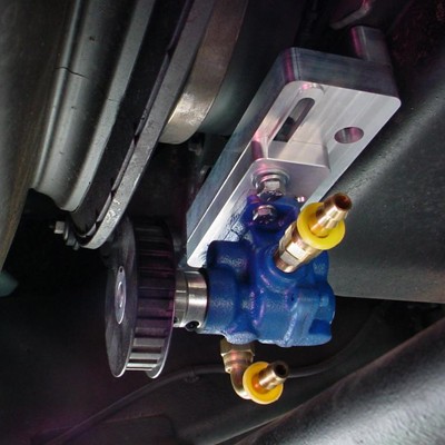

    Waiting on the shop to say when she is smoking. Decided with my lift pump graveyard to go with a "Belt-Fed" mechanical lift pump. Glacier Diesel Power FUEL BOSS mechanical lift pump system. The FUEL BOSS is a belt driven mechanical lift pump that increase output and pressure to match engine RPM... Eliminates the electrical relays, brushes, and other failures I have suffered. Even keeps the OEM lift pump as a backup and priming with an automatic pressure switch.

    I found out the AFE was indeed the Stainless Steel version after checking the cast in part number.
