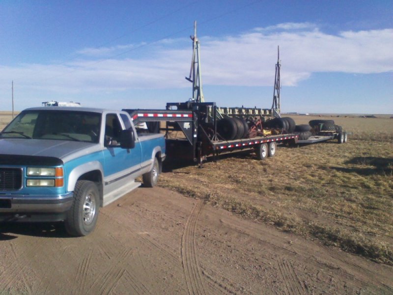

here is what mine can do on stock power and cooling. That said, mine are 5 speeds, so more power to the ground and less heat in the cooling stack.
Blue and Silver is sitting a 26,000 combination. handled it like a charm, ran in 5th if I wanted, but kept in 4th and slowed down some for the sake of the tires and bearings on the back trailer. flat western KS, some hills pulling out of creek bottom areas, but nothing long or bad.

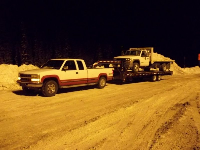

Red and White 93 is sitting at 21,xxx combo weight. This one was the hardest I ever pulled a 6.5L, Christmas Eve 2015, Vail Pass, I70 East bound in the Rocky Mountains. a long 5 percent grade that transitions to 7 percent at the last.
(It is the pull that a 2011 6.7L Ford 1 ton Dually cant get a 18,000 lb trailer (plus pickup, so total closer to 27K combo) over 48 mph with the throttle floorboarded from a dead stop at Dillon to the summit. http://news.pickuptrucks.com/2010/11/chevy-vs-ford-in-heavy-duty-rumble-in-the-rockies.html )
Every hill prior to this I had always had plenty of power in 3rd, but not this. once we hit the 7 percent I had it pinned and it was still falling, finally had to give up and drop to 2nd and chug on up.
For bone stock, IMO they both do quite well. both are 5spds with 4.10s and are identical powertrain wise except for the year.
SO if that is what stock can do, imagine what just 20-40 horse more would do.
