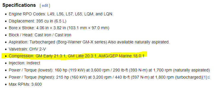

According to this, the Optimizer should be 18:1 compression already (GEP/GEP). I don't find wiccapedia to be the best source of facts, but it does cause me to question this below.
en.wikipedia.org
I guess I thought only the marine engines were 18:1 right out of the gate. Bad information on the World Wide Web?
Detroit Diesel V8 engine - Wikipedia
