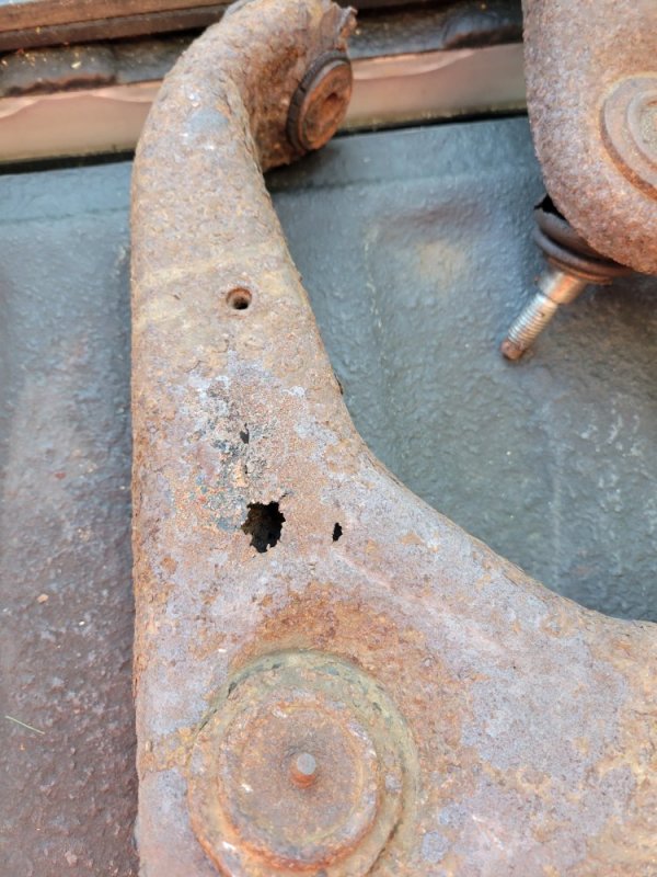

So started in on injector replacement and the shop was at least partially right. The bushings on the passenger side upper control arm are shot:
Now it’s not the rubber that’s shot, rather it’s the inner sleeve that rides on the bolts that is worn. These were replaced when I first bought the truck which was 82K miles ago. Obviously I need new bushings, but will I need new bolts?
Rockabillyrat
SlIgHtLy StUpId.
656
1,572
Ohio
You can get the bolt kit from napa. Anytime we do control arms we replace the bolts to make the alignment easier. If the come apart with no issues you can clean them up and reuse them. Here in NE ohio they usually are so rusted we have to replace. Gotta love the salt 😑

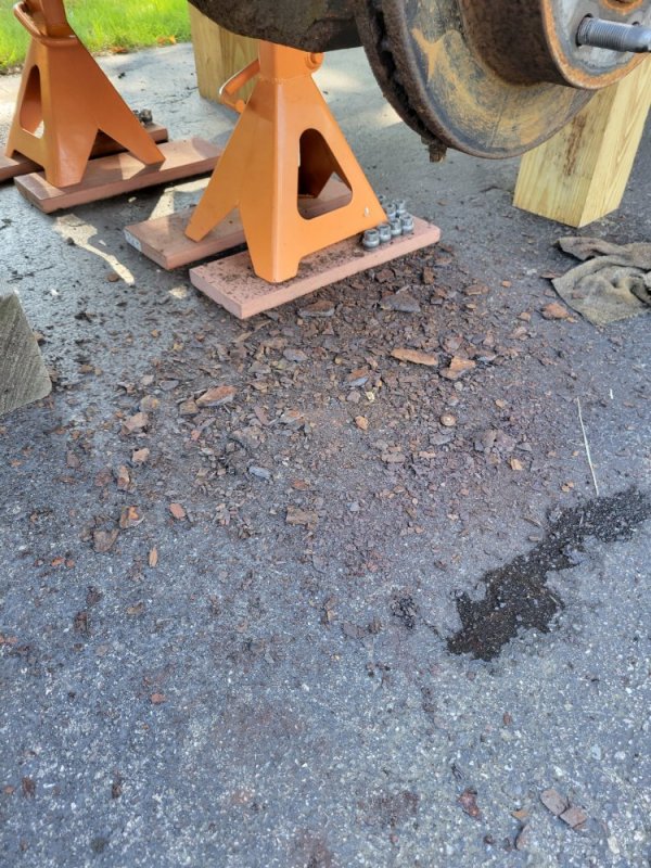

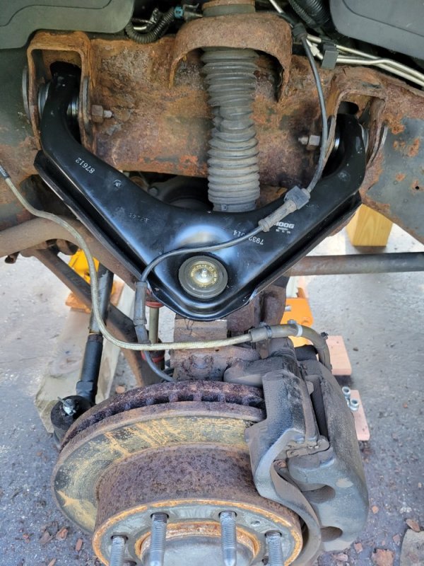

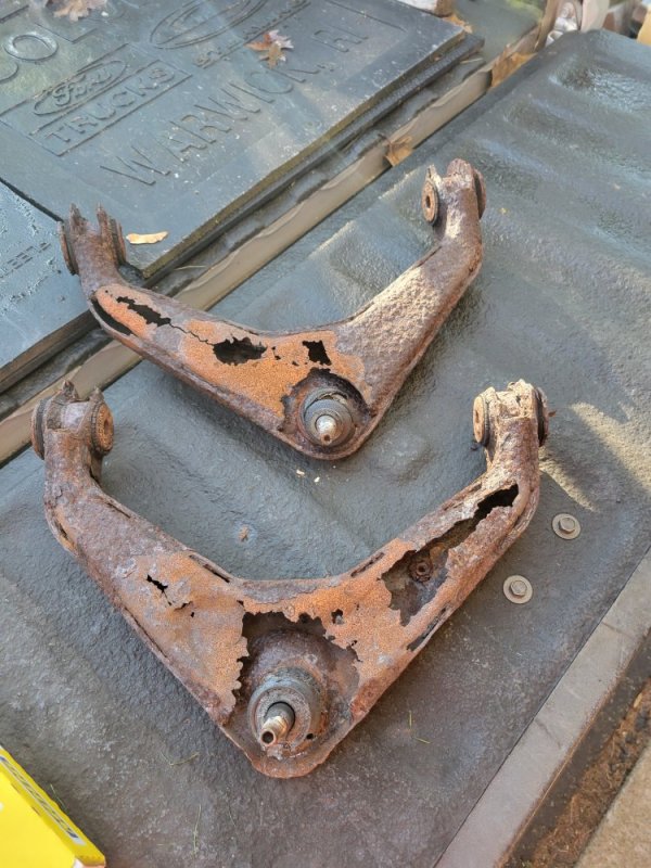

I just replaced inners/outers tie rods and upper control arms. Mine were still tight but I was worried they would snap in half from the corrosion.
Losing steel by the pound. 🤨
Just waiting to get front end aligned and new U joints.
