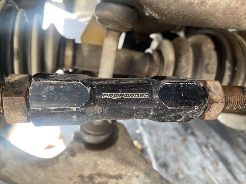

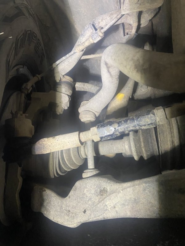

The tie rod sleeves are by ProForged:
I’ve done the tests for worn ball joints and tie rods and there is NO PLAY. I think he was scared off by the grease from my recent lube job and thought they had blown out. So I cleaned them all up an will take it to a pure alignment shop.
