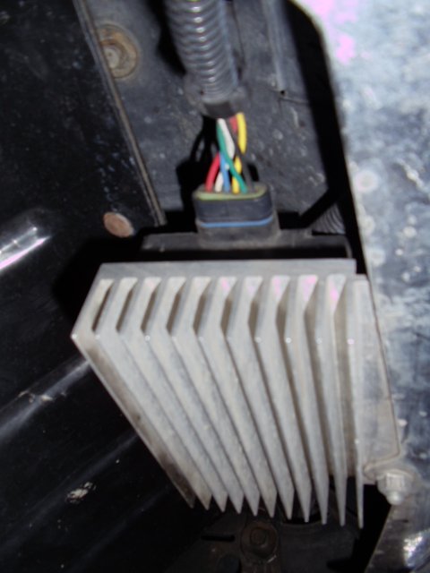

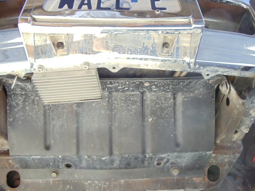

From a previous posting on the topic. First picture was using just one Air Dam attachment point/hold. Second Picture: I'd drilled two holes. Even with that small of a heat sink, it started to crack from vibrations.
