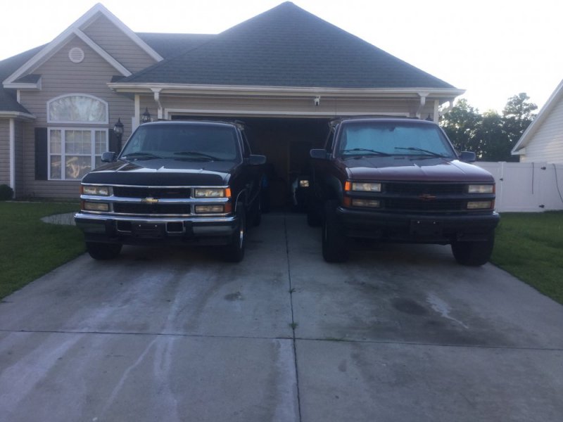

IMG_1445.JPG Okay, this is my first time posting in this section. I just picked up a 2 Door 6.5 Tahoe. She currently sits on the stock 16x7 wheels with 265/70/16 tires.
I don't mind keeping the stock wheels but I want a more aggressive look. The reason I don't mind keeping the stock wheels is that I'm not really crazy for most after market wheels they produce these days.
I'm not too sure if I want to do any type of body lift or suspension lift. A lift might come later on down the line. For now I need some help with trying to figure out how to get my more aggressive look with the good old OEM stock wheels.
I want to see if I can add a spacer to the fronts and back to make them stick out a bit. Or can I just buy wider tires? She currently has 265's I would like to go with 285 or 295 if possible for some more ground clearance. But I want the wheels to stick out of the wells at least bare minimum 1 inch.
How can I do this with no trimming, cutting or rubbing? Is this even possible?
My girls 5.7 has 305/70/16 and I really like how it looks.
Thanks all.

Any pics I can see?

The way she sits now she drives awesome. Maybe I'll just put tires to get a little more ground clearance. I would like to see some pics though of some aggressive looking 6.5s if yall have them.
I'll have to look to see if I have any pics. I could not find any that showed a side view
