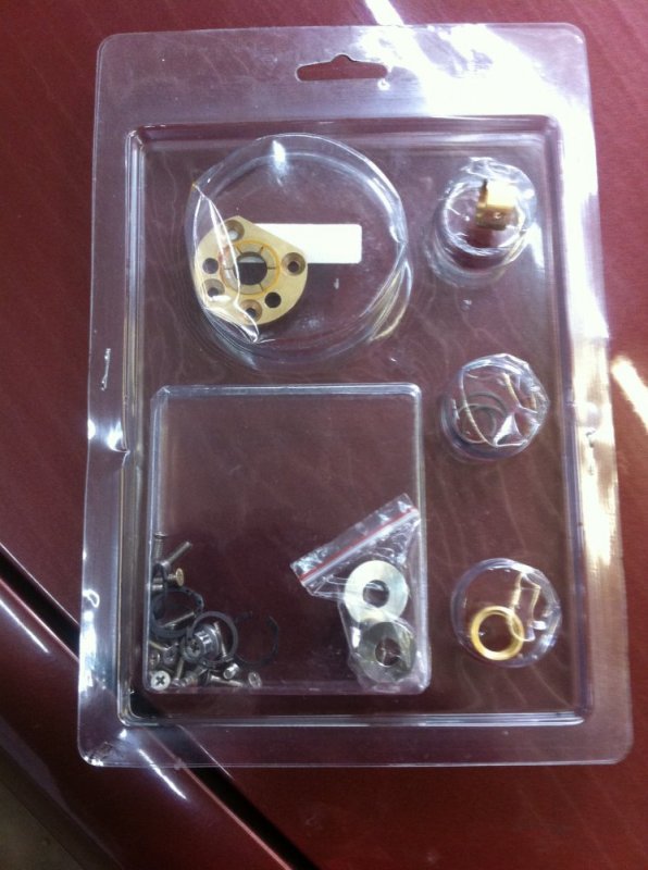

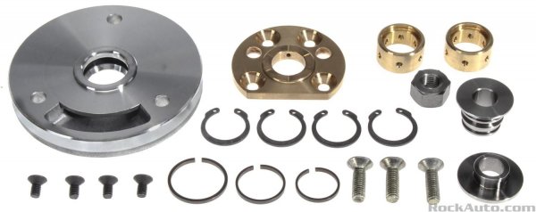

Кто-нибудь скажет мне, что такое другое?
Оба комплекта перестраивают для одного и того же турбонаддува. Я не понимаю.rebuild kit1.jpg rebuild kit2.jpg
One on the bottom is missing a short screw.

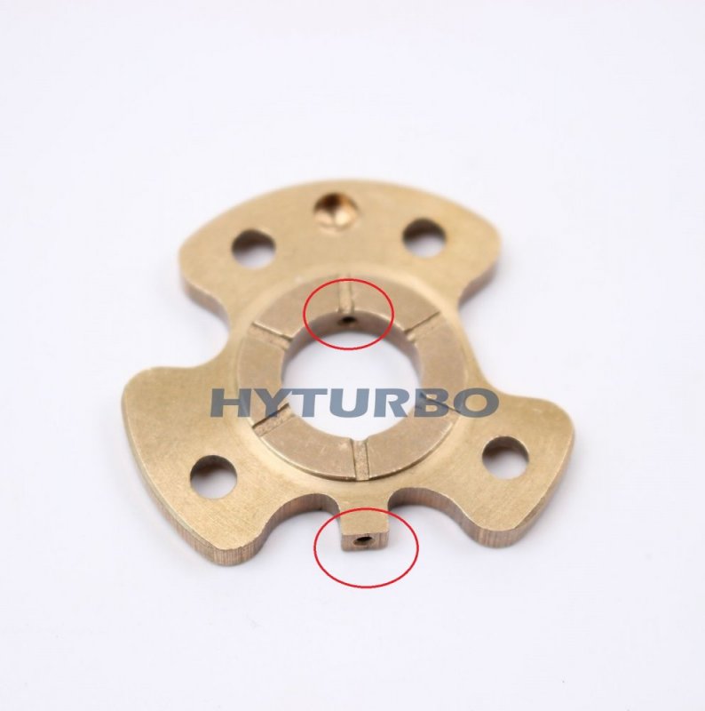

The gold looking flange is different.
Also long screws on top look like stainless?

Top one looks like the one I've used before. Looks like the only difference is the one brass piece and I bet even it would work
been awhile since I had one apart holes my help or may not. The kits I bought were around $50. I did pay about $90 for the first one I bought the $50 one was about the same quality

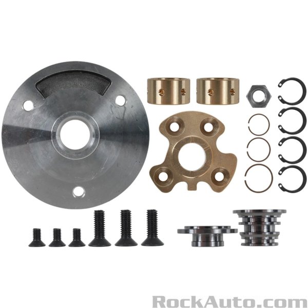

This is what I have, when I think about it, it would be for a GM-8 turbo.
