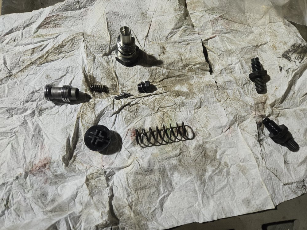

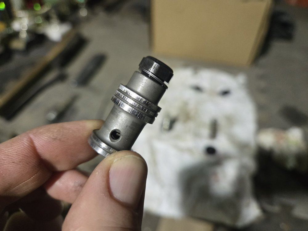

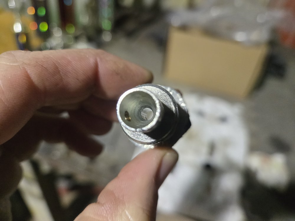

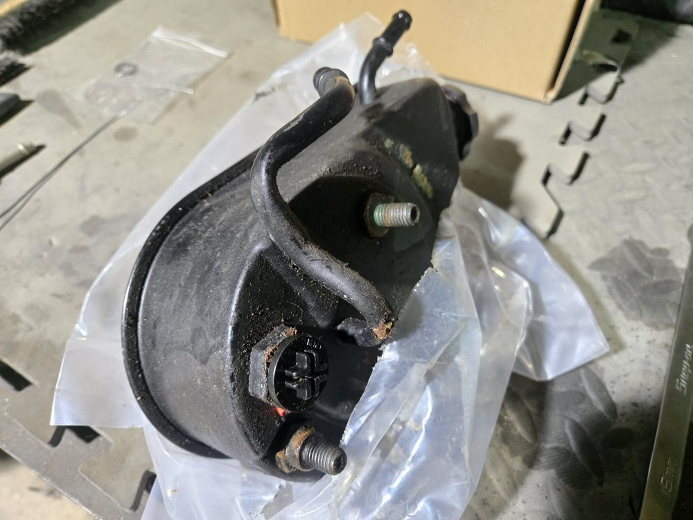

In the meantime I will find the old Napa (Cardone) pump in my basement and dissect for inspections. Next time I go to the JY I will try to find an original PS pump and hydroboost setup for the parts bin. No more reman or aftermarket for me.

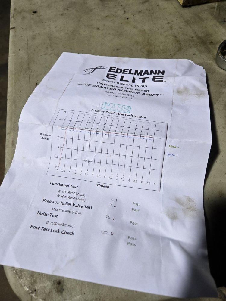

Grabbed the old Napa/Cardone unit. Found the QA/QC paperwork for the current Edelman in the vehicle. My understanding is it tested to nearly 1.45K PSI.
No point in trying to mess with PSI on it, that's really the most we should ever need. I still have yet to create the hard steering symptoms. The last time it did it was navigating a parking lot last weekend. Currently driving the Yukon everyday even to work over the company truck. It definitely cruises the highway so much nicer than my F250.
