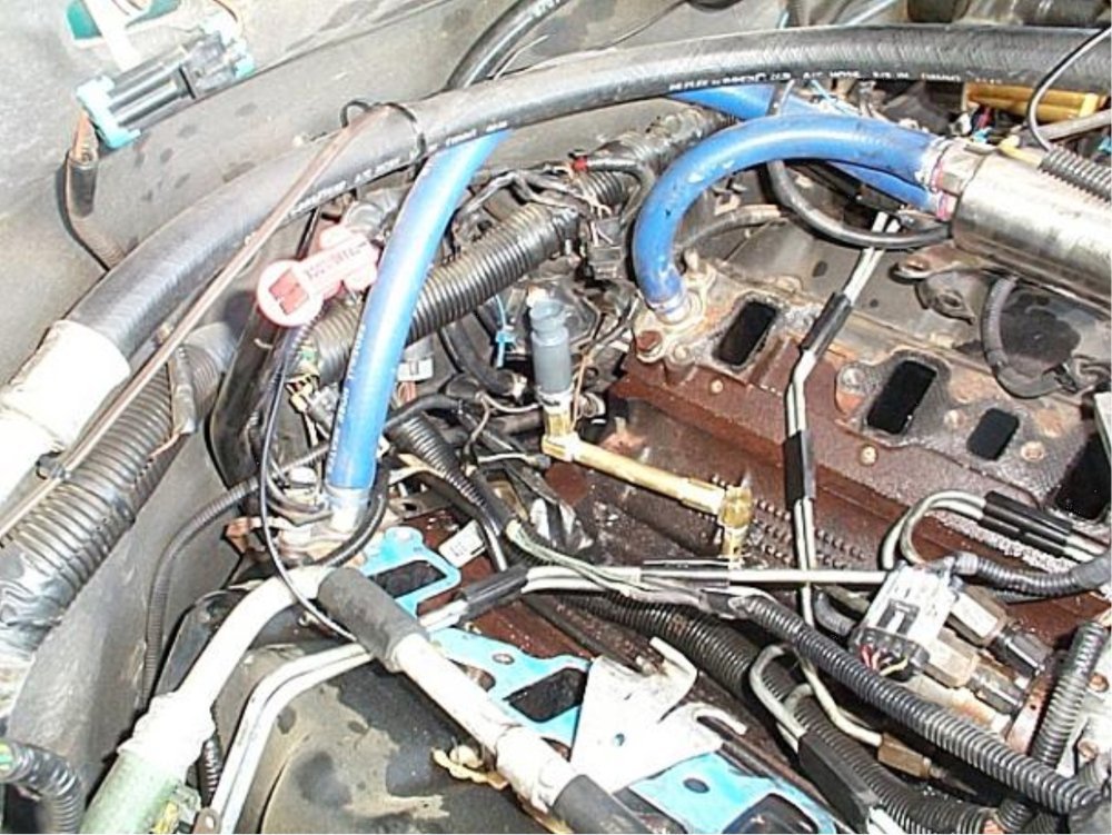

Heath used to sell a 'Balance Flow' kit that utilized the rear passages to try to improve the driver/passenger bias but, the new GM Pumps made it all moot given the price points. TurbineDoc used to run it. It could be seen in some of his reference pictures in the stickies. However, with all the busted links and failed picture transfers when the stickies were updated, I don't know if they're still visible so here's one I saved from his thread on relocating the OPS.

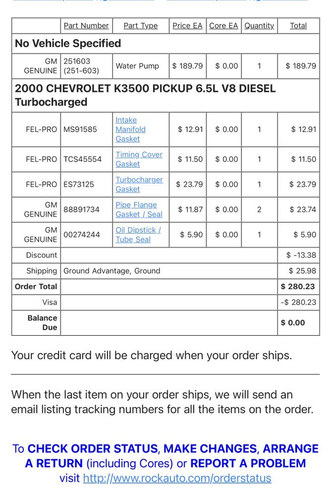

Here is what all is on the way.
When I did a highlite and copy, then pasted it into the RA search function, this is the pump that it came up with.
I hope it is as good as the AC Delco unit.
It was quit a bit over the price of the AC Delco pump.
