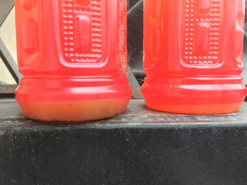

This is the fuel I flushed out of the FFM. Ran the lift pump and sucked 2+ quarts out of it. Since the water in fuel light came back on, I will have to repeat this.

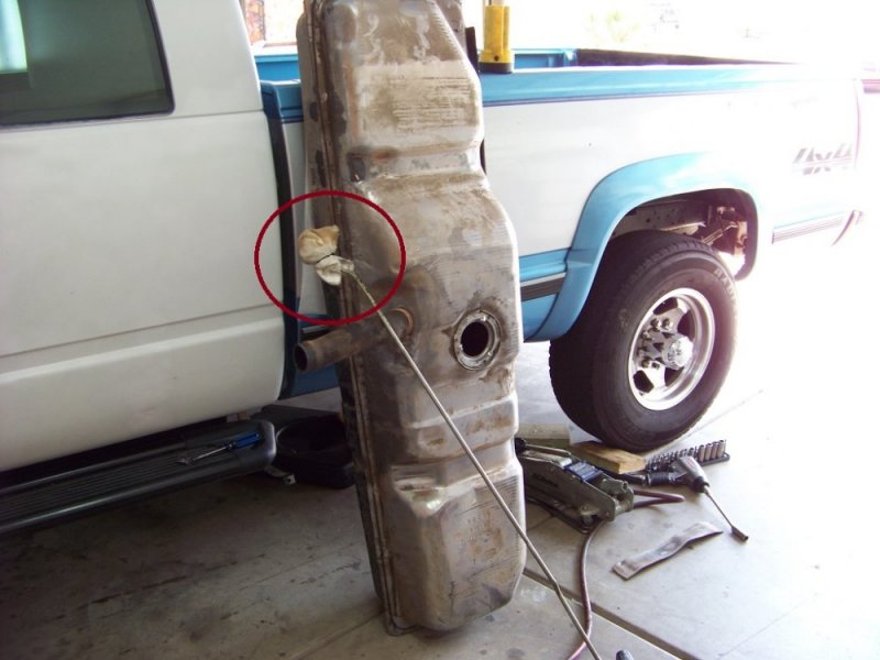

Don't recall having to ruin or wreck anything on the burb dropping the tank, but, been awhile. Check out the "q tip" I made to swab out the tank. In your case angeling the tank to get the water off the bottom is what is needed. Maybe raise one side of the vehicle so the suction hose can get to the water. 100_3301.JPG
I could not figure out how to remove the ring that locks the sender in place.
In that pic of the two bottles of fuel, it looks like there's still emulsified water mixed in the fuel meaning it had not fully settled out.

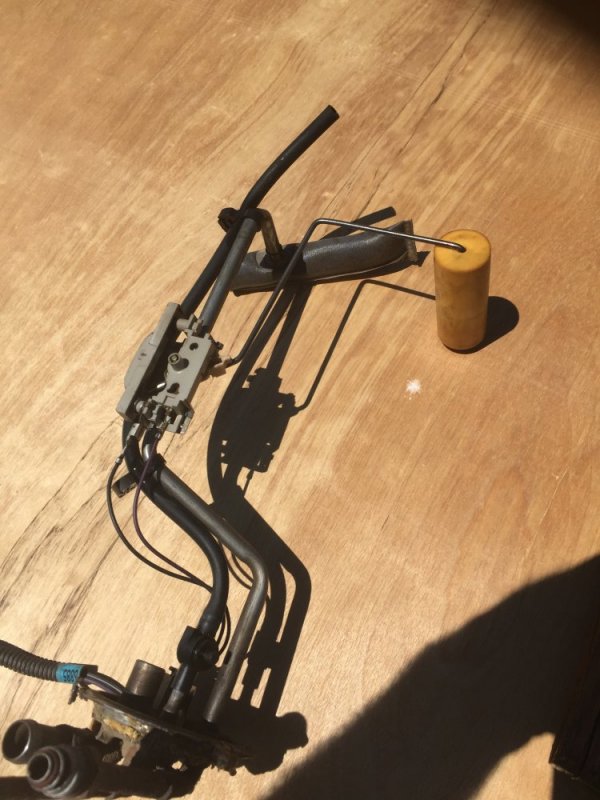

I'm dropping the tank today. I have a new sender/pick-up with new lock ring and gasket. I will swab out the tank with a puppy pad on a stick. Need to drain the return line. Then I will have everything gone. Fuel has been run through Mr. Funnel Filter 2x.
