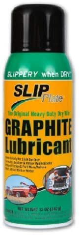

Experience with the spray-on stuff is not good when it comes to mower decks. Product is the Slip Plate spray.
Expectation was to either minimize or prevent clumping of grass as even when the lawn is dry, the grass has enough moisture in it to clump on an un-treated deck.
The first application was simply sprayed-on to a clean push-mower deck and immediately put in use. Stuff was completely gone after about 45 minutes.
Tried again and this time read, and followed directions. Cleaned the deck, waited a day for it to dry, sprayed the slip plate, and waited 4 hours. Actually, it was a couple days of cure time.
After about 2 hours on the 2 blade deck, grass was clumped-on and a wash showed that the slip plate was pretty much gone.
After about 4 hours on the 3 blade deck, same observation as the 2 blade deck.
I did a search on the Tube and it seems like there are reports of the stuff (as made by various manufacturers and specifically designed for mower decks) not lasting much past one mowing.
Question is whether this the correct application for the job, do the instructions need adjustments, or should I just wash the deck after each use and repaint as necessary without bothering with slip plate?
Nothing I've ever found works short of cleaning the deck by hand. I became far less anal about keeping the mower deck clean as years went by. I regularly mow 5 acres of grass the last 15 years and 2 1/2 for the prior 20. If its cut... I'm good.

Graphite paints are used in farm equipment hoppers and on leaf springs with good results...they do not wear off like you describe.

Really is too bad that Slip Plate is not living up to its hype in this scenario.

We mow about 5 acres and have had good luck with slick plate. We run Gator blades.
We also power wash the bottom of the deck about every time we mow.
The slick plate - I don't know which brand, seems to last about 1/3 of a season.
We aren't very fancy about coating the deck. We lift it with the loader, power wash it, dry it and slob the slick plate on. We buy quarts or gallons.
I ordered an epoxy product made for the bottom of air boats, that I haven't got a chance to try yet.
Most damage I have seen on decks was the result of not cleaning and protecting them/rust. The decks are way to expensive to not care for
We have been happy enough with the results to keep using it. We've used several products including anything we happen to have on hand. Any paint, used oil, Amsoil metal Protector. Oily stuff, obviously doesn't work so great. But anything to keep the deck from rusting.
