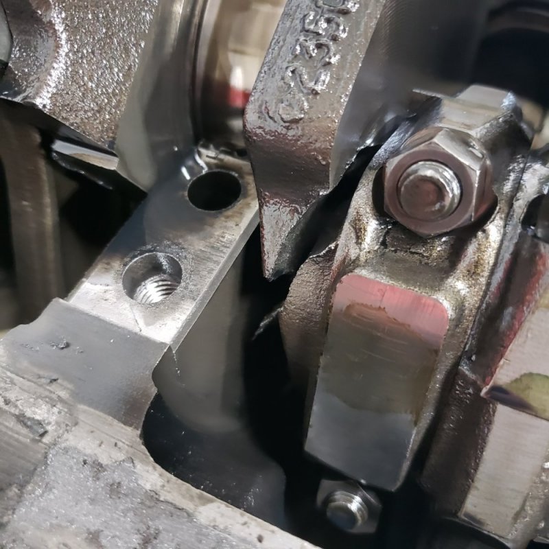

My crank didn't break but, my block was cracked at the #7 cylinder. I bought the Optimizer and never looked back. My original mileage was only 93k so I figured my truck (1/2 ton) was worth the cost of a new motor. I looked at like this; many hot rodders spend 10's of thousands of dollars on "old" cars so $7500-8000 on an already nice truck made enough sense to me...good luck with your decision and keep us posted!
