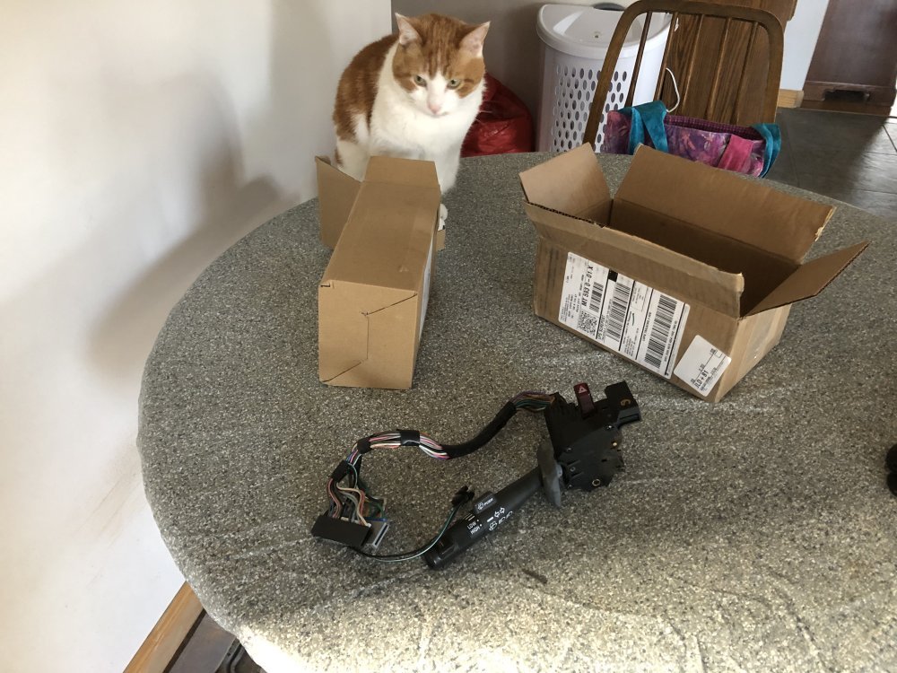

Successfully made the swap today. In a sense, dbrannon79 was correct in that one really doesn't need to remove the steering wheel IF you have a means of accessing the forward screw w/ a T-25 torx "L" vs wanting to hit it with a socket. So, no airbag or steering wheel removal and I didn't have to remove the key cylinder to remove the top cover either.
It became apparent early on that a previous owner must have done this job before. The lower column cover was missing a screw and both the screws that hold the top column cover are AWOL. The top cover slipped right over the key cylinder too. The 7mm screw that secures the main connector to its mount under the dash was missing as was a "green safety clip" on a two wire safety switch on the gear selector linkage. Shortened the work being able to skip more than half the main steps.

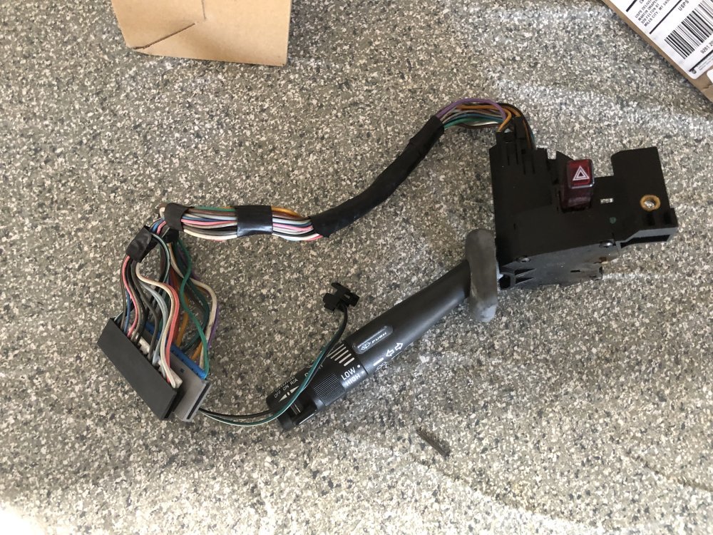

Old multi-function switch was pretty worn out. A lot of plastic debris at the cancelation lever, a copper floating pin was unrecognizable and while there was no visible damage to the wiring, connectors or contact points, all the wires looked old. Almost browned from age or heat.
Anyway, everything works as it should so, one more thing off my list of 'some day I' gotta address that' list.
