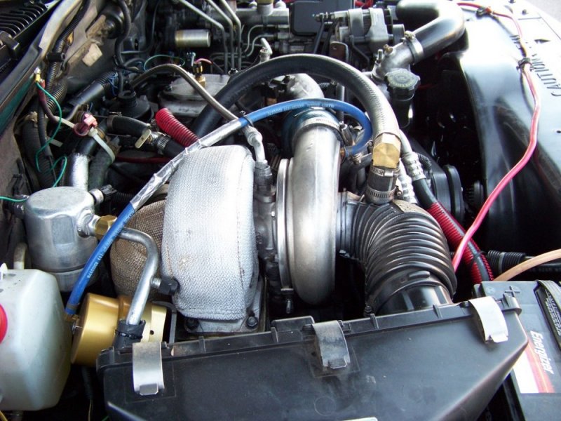

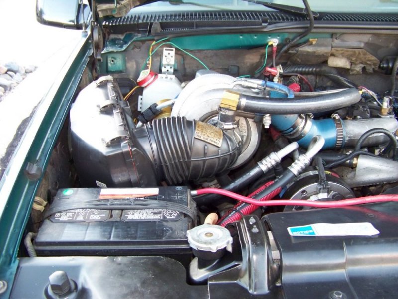

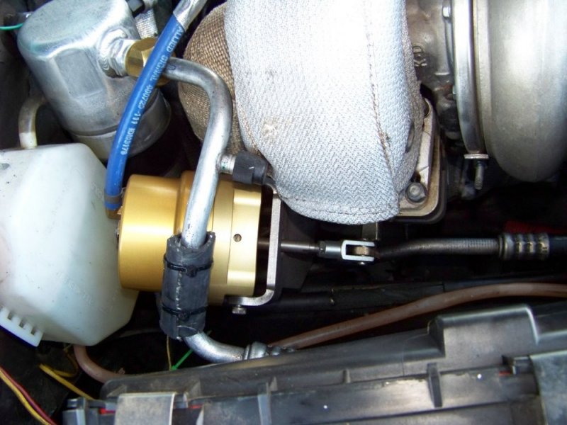

I ditched mine just because I had a good deal on another turbo an can't leave well enough alone. I like trying new things. Looking back I regret selling it. It was some of the best money i spent on the truck. It Even made daily driving 10x better. Closed it acts about like my 12cm housing hx35 did spool wise. Open it really let things go fast. I may be going to a larger turbo again if my custom exhaust manifolds work out well. Will update with pictures of install after the new year guys.
